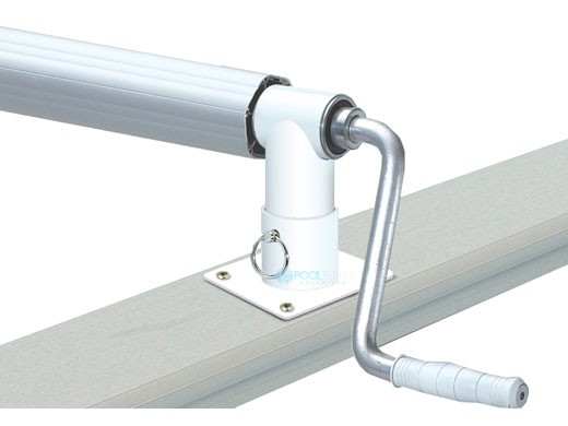

Also, I am [predictably] underwhelmed by the flimsy pool cover reel (my review with photos is posted here) and contemplating DIY options after finding no retail alternatives without complaints of sagging or failure. Perhaps something sturdier could be assembled using 2” EMT conduit (assuming I am unable to find aluminum irrigation tubing) and the old SUV hub bearing assemblies I have in the garage (essentially pillow block bearings, assuming simple saddle mounts would be inadequate). Searching this forum revealed some ideas, but none that I believe will meet my expectations. Thoughts?
I have been happy with this reel on my 24’ pool.
Since yours isn’t as wide, the 3” tube model might work for you as well.
It won’t mount to your soft side pool, but I mounted mine behind my pool on 4x6 posts. It works well for my pool which is round, but I think that it would work even better on a rectangle.

I remembered that my reel kit included surface mount brackets as well, so for now I decided to use them rather than the flimsy, broken, plastic, top rail clamps. The tube of my Intex XTR pool has an O.D. of 2-1/4", which is close enough to the 2-3/8" O.D. of 2" EMT conduit and chain link fence terminal posts, so I modified four brace bands (~$10 total, but may have to replace with something stainless if galvanized doesn't tolerate proximity to or the occasional splash of chlorinated water) to serve as open clamps to which I mounted deck lumber as a base. It works great (the length is key for leverage), and when the next part of my reel breaks, it will be easy to mount something far more robust (DIY if not one of the GLI models recommended by @cowboycasey and @magiteck ).
