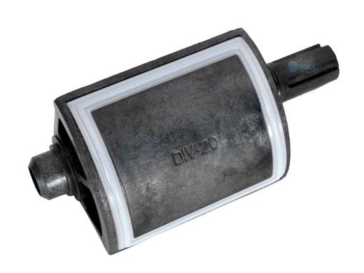

For some reason, that old diverter reminds me of a Compool (Pentair) diverter rather than a Jandy. Usually, you can't swap diverters between brands though, and I never tried. The ridges at the bottom and the hole aren't something I ever remember seeing on a Jandy. Haven't seen one like that in a very long time. This is a Pentair diverter:
