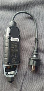

2.1 Opened the AC-mains TEST/RESUME device (integrated into the AC-cable between AC-Mains and Intex pump), removed the 3 leads on the 'Load' side.
2.2 Connected the 3 leads to a European AC-plug.
2.3 Stuck an INNR Smart Plug into the AC-mains
2.4 Stuck the AC-plug from step 2.2 into the Smart Plug from step 2.3

Some photos have been added to this message as well explaining what I did.
