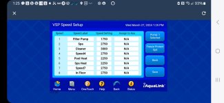

I have set a schedule in the WEB app to basically run 24/7, but it does shut down and restart once a day. The Intelliflo just appears to be changing speed on its own. Although I have the Pentair Home app, I only use it to monitor the status of the pump. Attached are the screenshots of my iAaqualink WEB interface.

When does it run at the higher speed? Did you change any of the keywords on the speed screen? You should not change them. "Filter Pump" should be "Pool".

Thank you. Ok, I actually did change that label but have since changed it back. It seems that the change in speed is random. I did run in spa mode at 2750 rpm for a few minutes and changed back to pool, but it did not change speed to 1750rpm?

**Looks like you changed "SPA" to "Spa" too. Change them all back to proper case.
