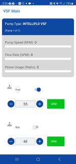

Just for info, here's a screenshot with the pool pump 'running' but not actually running, and the same photo with it genuinely running.

2.006 has been bug ridden and Pentair pulled it from release.
2.017 came out last month. I would update your panel to 2.017 and see how things work.
Pentair was supposed to begin pushing OTA updates of 2.017 this month.
Reactions: MyAZPool
That worked! Will monitor, but on a quick test it behaved exactly as I expected -- switching bodies, the pump goes to zero, the valves move and the 30s timer counts down, then the pump starts up again.
