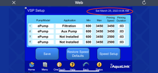

My guess is that your IFCS and your pool are scheduled to run together. Your two pumps are both VS speed pumps, so they would be controlled by a small cable and not by a relay. You should be able to schedule your IFCS to run at a time that does not interfere with your pool use.
Can you post your run schedules???

@Jimrahbe photos below of the run schedule with speeds.

It appears that your filter pump runs from 8 am until 5 pm at 3000 RPM.. and your IFCS/Vanishing edge pump runs 24/7 at 1750 RPM.
3000 RPM seems pretty fast to me... are you sure the surface bubbles that you show in your pool video are not from your main pump???
You should be able to set the IFCS/Vanishing edge pump to run a lot less than 24/7. I am not a Jandy guy, but it appears you just highlight the vanishing edge schedule and hit Edit, and change it to the time you want it to run, then hit Save..

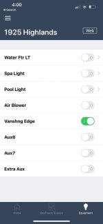

I think it's worth noting here when I turn off "Vanishing Edge" in my iAqualink the vanishing edge stays on, the cleaners stay on, and the pump attached to them stays on.
