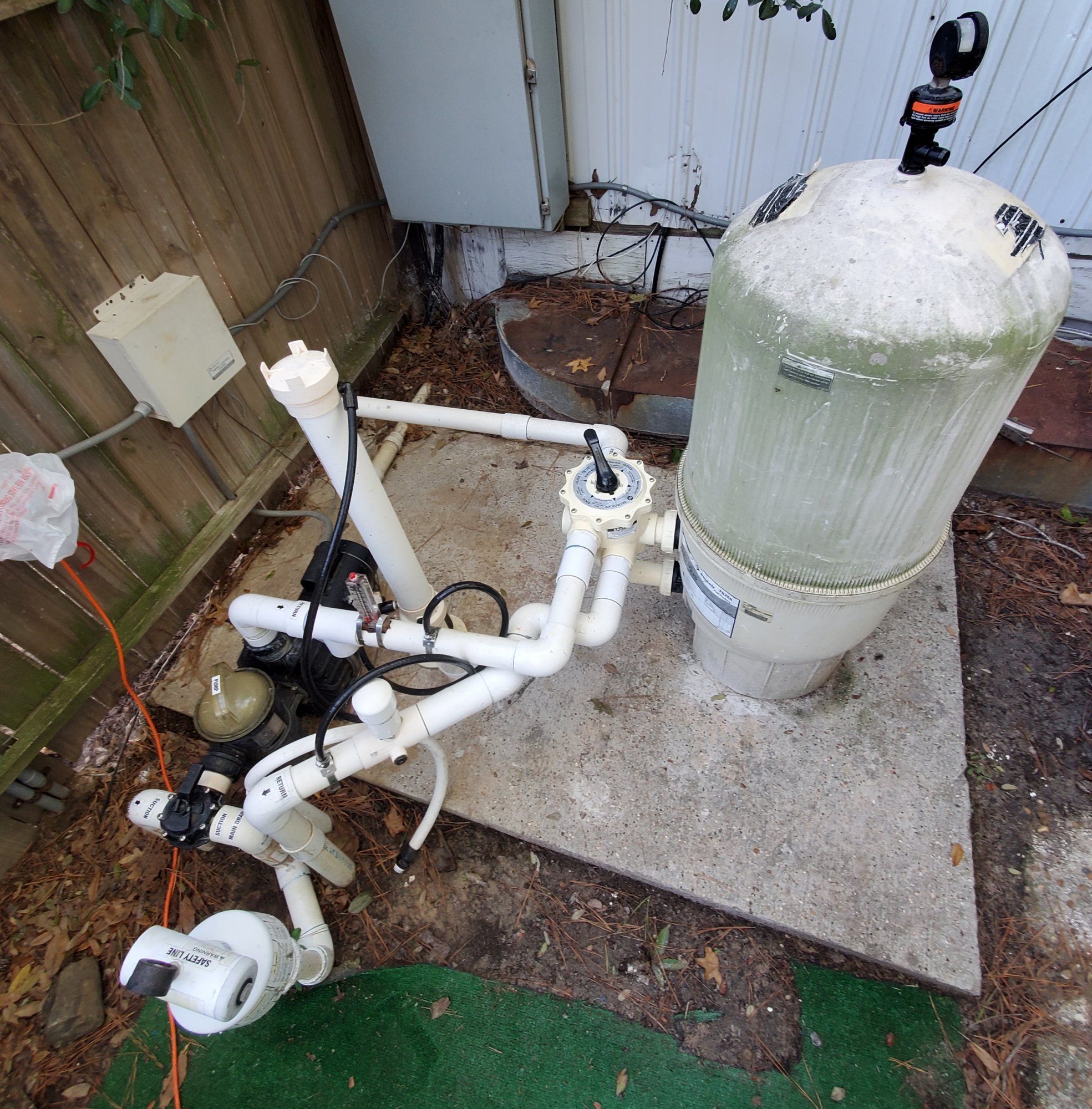

Pump flow lately only reaches 70-80 gpm instead of 100 gpm, and filter pressure is only 10 psi.
Weird and your system in post #18 seems pretty simple and straightforward
Reactions: Ignoramus
PROBLEMS
1. Pump flow lately only reaches 70-80 gpm instead of 100 gpm, and filter pressure is only 10 psi.
How are you measuring the GPM?
What makes you think you should be getting 100 gpm?
It looks like you have 1.5" pipe to the pool and 2" pipe on the equipment pad.
You want to keep the water velocity below 6 ft/sec on the suction and below 8 ft/sec on the pressure side of the pump:
Pipe Size6 ft/sec8 ft/sec
1.5"38 GPM51 GPM
2"63 GPM84 GPM
2.590 GPM119 GPM
3.0"138 GPM184 GPM
4. Is there a writeup on how to troubleshoot main drains? I think one isn't getting much suction. This is situation this morning (pump has been running since 8 pm when I took the picture). I've added a picture of the drains without leaves.
Main drains don't have much suction.
Does the pump run fine when the diverter valve is set to just run on the Main Drain?
Flowmeter. And now that I looked at it carefully, I was reading wrong scale - I used left scale, that's designed for Schedule 80.
Anyway, max flow I had seen was 100 on Sch 80 scale. And now I'm getting maximum of 80 on the same scale.
They are both 2".
1.5"38 GPM51 GPM
2"63 GPM84 GPM
2.590 GPM119 GPM
3.0"138 GPM184 GPM
Hmmm, does this mean this equipment isn't plumbed properly and needs to be redone?
At the moment,
Drains + skimmers produce flow 80
Skimmers - 65
Drains alone - 40
(All readings on left side of the flowmeter, for consistency of numbers. I will go back and replace numbers, when I can change them all at the same time)
Why do you think you need more flow then you are getting?
Because I've seen more flow in the system and lately I've been seeing bubbles in returns and pump skimming pot.
And because I think that with full flow I might get better suction with manual, skimmer-side vacuuming; it feels almost nonexistent compared to the robot.
Thank you!
60-80 GPM is plenty of flow.
More flow is not going to fix those perceived problems.
Skimmer suction vacuuming is the worst method of cleaning a pool. It’s performance is dependent on the equipment setup and plumbing more than flow. Some pool sunction systems are not setup for vacuuming.
That is why pressure side cleaners and robot cleaners were invented. Pool suction side vacuuming sucks.
I think these are related. When I saw greater flow, I didn't have that many bubbles in pump skimmer, nor in return lines. Speaking of bubbles, how much of aeration (pH increase) does all this bubbling action provides?
Skimmer suction vacuuming is the worst method of cleaning a pool. It’s performance is dependent on the equipment setup and plumbing more than flow. Some pool suction systems are not setup for vacuuming.
I felt the truth of this. :D
LOL

Air leaks
Chasing the source of air bubbles in returns, I've checked pump bulkhead connections and they seem OK. But I have found leak at the drain of pump filter pot. It looks like a crack in the center seam of the pot. I've shmeared it all over with Lexel caulk for now, but later read in the fine print (yeah, i know I did a stupid) I've read that it's not designed for constant water contact.
Is this kind of crack patchable, in general?
If I could scrape off Lexel without completely damaging the pot, what's the best adhesive for the job?I've found few leaks in the filter.
I've replaced MPV drain o-ring, checked MPV flange o-ring and spider gasket adhesion. And I've replaced filter drain o-rings and both bulkhead o-rings. Next up is o-ring in pressure relief valve: if I plug the outlet (valve closed), I get water leaking from somewhere inside.
What other sources of air could be in my system? The two things I've not yet touched are VacAlert and Jandy selector/diverter valve in front of the pump.
