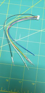

  9. Crimped 2.54mm male Dupont headers onto my JST connector to that it could plug into my USBDM. If you don't have crimpers & pins you can just solder male headers/pins onto the end of the JST connector leads. I used the following pinout:
    • My 6P JST header cable had the same colours as the image below so I used that as my reference
    • Poped the case off the USBDM programmer and with the help of the printed pinout on the PCB and a multimeter, I determined which pin was which on the end of the programmer cable.
    • Matched the Programer pinout to the JST pins with this legend:
    • On the Micro JST plug;
      1-White = Gnd
      4-Yellow = Reset
      5-Black = BKGD
      6-Red = VCC
    • Threw some electrical tape on to secure the connection but this is what I ended up with:
