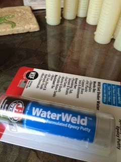

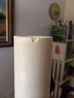

OK...we used JB liquid weld and repaired the little nick at the top of the tube. We took off all of the laterals and cleaned them. We took the top off the filter and cleaned the spider gasket again and cleaned the big O ring gasket on the filter top. Whatever we did worked! No more sand going into the pool or out of the backwash tube..Everything is working. I do want to say that the shop vac worked wonders! Much easier than scooping out all that sand. I filled 3 5 gallon buckets with sand and still ended up with some more in the vac but it's all back where it belongs now. I didn't lose my chlorine level and I can actually see the entire bottom of the pool even though its green water. I have high hopes that tomorrow or the next day it will actually be blue...I am just happy its working. I really wouldn't have had the guts to do all this without the support from you guys though..thank you so much for all your help..I really do appreciate you all..Kim I'm having a cold one now thinking of you as I do! Pizza sounds good but tonight is frozen Pot Pies as I am way too tired to cook...good thing I have an understanding hubby..I will post pics later...promise! Thanks again my friends!
oh and Jesse WV...we did plug the stand pipe and made sure no sand got in it...I just dont know what happened but it works now.. And to the pool company that said I just need a new filter...they can kiss my _____!!!!!

I figure the cya must be down due to all the backwashing and adding water. Thje pool looks pretty clear..just green. I did add some PH down and am getting ready to vacuum again. At this point do I just keep slamming the pool? I know I need to let the FC come way down. Do I need to add stabilizer again or wait until I'm clear? I am including pics of the broken collector tube and the stuff we used to fix it as well as the ongoing water photos...may need to use more than one post to put them all on..The first pic is the water today...the second was 3 days ago.
OK, here is the pic of the collector pipe and what we used to fix it...
