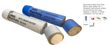

Draining will give better results if you can do it safely.
Just mix up the plaster patch or putty and fill in the hole.
It's not that complicated.
It's not any more complicated than patching a hole with patching compound.
It is a bit more challenging doing it underwater.
