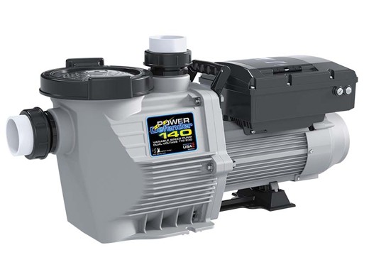

You need a better pump for starters, one designed for an in-ground pool. For a pool that size, your best option would be a VSP. Run it at a higher speed for a short while to skim and then at a low speed for a very long time for great water.
Unfortunately there are very few that run on 120V. Waterway markets this as an above ground VSP, but it is a Waterway 3/4hp Champion with a variable speed motor ( I recognize the wet end as I probably installed 50 of the single speed pumps). It will run on 240V or 120V. It is also the only VSP that supports both voltages in that price range in a name-brand pump.

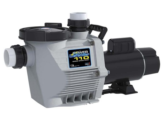

If you don't want to get the VSP, look at this pump, its the same as the above with a single-speed motor (the VSP will pay for itself in energy savings, so it is the better choice).
