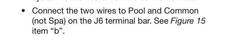

Hmm, the manual says to specifically hook low voltage up to pool/com. But you said it worked previously. E85ED146-D6F4-4D6F-B8EC-FE897CA3697B.jpeg
It’s just a setting to save temp for different profiles. It’s designed like that for older systems. There is no difference on how the heater works between the 2.
I hope I’m not missing something, but I would turn the power off and move the low voltage on the heater board so it’s connected to pool and com and run the same tests. It doesn’t explain the fact that it worked previously though. Unless it was user error and it only appeared it was working the way it should.
