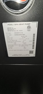

Need some help with my new Ruud (Raypak) heat pump, hoping there are some of you that have the same 6550 series Crosswind V. We bought from Recreational Warehouse (Model number delivered was 6550IT-E) and sold as a 118k unit. It was installed a few days before Thanksgiving and initially we had great results with bringing the pool up to a ridiculous 88 degrees pretty quick. Had some cold weather, and over time, and based on a LOT of spreadsheet math, I started to question what was going on with pool temps, and demand on the heat pump over the last few days. And not to mention, coincidence or not, it all started after an OTA update for the heat pump...

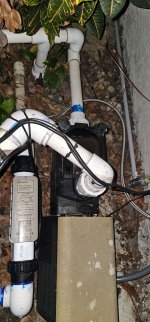

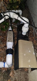

Integration and simplicity of same is very important for a new pump, so suggest away. And, forgive the pics... still a work in progress so a lot to tidy up. Just wanted to add them to give an idea of the plumbing I am working with.
