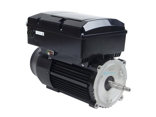

C-Frame, threaded shaft motor.
A Nidec NPTT165 motor will bolt on (with the required shaft seal, O rings, etc). Has its own built-in control. Considerably less at Pool Supply Unlimited. Are you sure the sealplate is not broken? Looks like it (or the mounting plate) is cracked down the left side looking from behind the pump.
Freeze can damage more than just the sealplate, it may have damaged all the pump internals. There is a kit for that as well. You'd have to take the existing pump apart to this extent anyway, might just want to get the kit. Be sure to look for any other damaged parts before purchasing parts, might be better to replace the entire pump.
