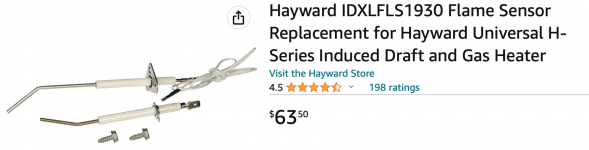

By the way, the flame sensor that came from Amazon appeared to be used and not the correct one I ordered so returning it. Was supposed to be an official Hayward, but what I got was not like the picture on Amazon. See pictures below.
