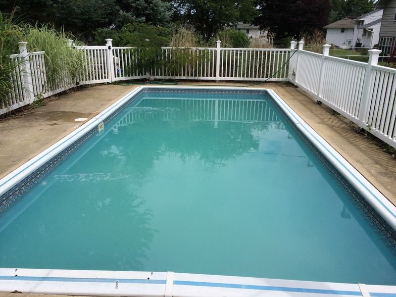

For the new peeps, this when the pool company opened
This is the Start of the SLAM as of today at 4pm (I removed tons of leaves and did guesstimated chlorine levels, until my k-2006 kit arrived, for a few days). Color hasn't changed for a day or two from me letting levels get to appropriate levels to SLAM

I didn't think the pool looked different from yesterday at 4pm but like you said i took a pic. and back to back it does look blue-er.
Yesterday at 4pm
Today at 11am
Can't tell until the pics are back to back.

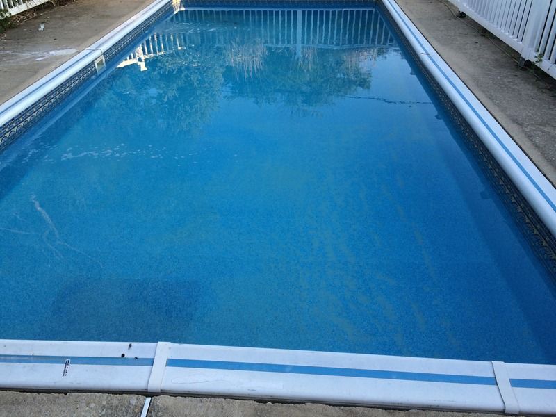

Success!!!!!!!
Its amazing what one day with filter that is actualy filtering can do!
Yesterday right after i cleaned the filter
This morning
Hard to tell in the pic cause it was early but it is crystal clear! the dark blue square is where the ladder usually is installed.

Yea less than 24 hours to be honest. Amazing when you actually filter right?!?!?!?
I still have a little CC .5-1 so i'm gonna keep running the SLAM going until i get that to 0. I have the wife babystitting the Bleach today until i get off work. when i get home i'll vacuum everything up now that i can see literally EVERYTHING!!! So i should have a clean and clear pool so i'm ready for my OCLT maybe tomorrow night. I don't care if it takes a few more days as long as it is ready by Saturday evening when my house guests arrive (crosses fingers).

Got home this afternoon and the FC had dropped a bit (My CYA is about 30-35 so not the best sunscreen) due to our 92* super sunny day. But as you can see i am crystal clear!! I vacuumed everything and got all the sand out of the pool so everything is looking good.

pic is from before vacuuming (you can see the dirt/sand on the right side of the pool bottom.
