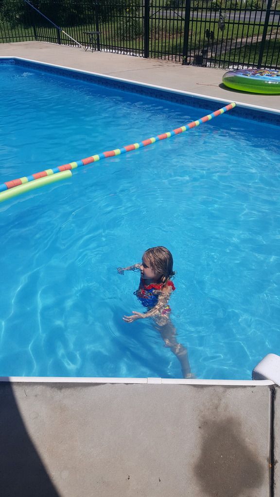

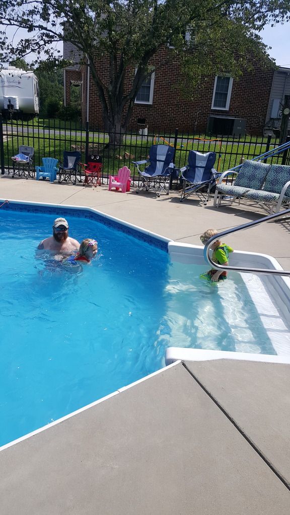

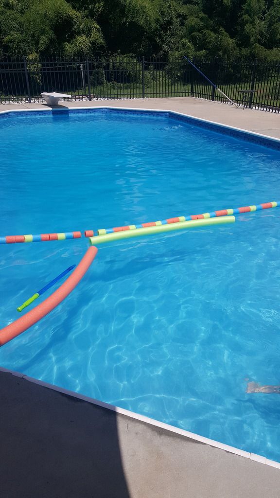

Hello again! Below are two pictures that I snapped on Tuesday while we were out enjoying our crystal clear pool. Your help and guidance have been invaluable. We have worked to maintain the FC everyday at a level 4 (we have achieved CYA of 30 and are checking it every weekend). So far, I have noticed that after swimming in it, the FC drops to about a 1, but on days when we do not swim it usually only drops down to a 2. We have also added muriatic acid a few times this week to bring down the Ph. We are continuing to be vigilant with this testing so that we don't fall back down the slippery slope to green swampland. Thank you again!
So happy that it cleared up! Might I suggest that you try to maintain a little higher on the FC? You really don't want to EVER drop below the minimum. No harm in targeting a little higher as long as your overall loss never lets you drop below the minimum.
