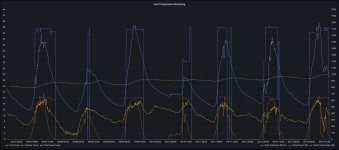

I'm interested in this but haven't fully got into the detail yet. I've been recording enough data to start to analyse and model it as I heat my pool for the start of the season. My key drivers for heat pump efficiency might be different to yours. I have a solar pv array on the roof and generate enough excess power to run the heat pump for ~7 hours per day during sunlight hours.
I'm currently collecting data on
  • Water temperature
  • Outdoor air temperature
  • Indoor air temperature (my pool is enclosed in a separate glass structure)
  • Solar irradiance
  • Heat Pump power usage
  • Pump power usage
The last week of data looks like this:
My pool is in an enclosed space so not open to the wind and somewhat insulated from the outside air. I keep a solar heat retention cover (Heat Retention Pool Cover - RaeGuard™ - With GeoBubble™ Technology) on it almost all of the time while I'm waiting for it to get up to temperature.
I may be a bit optimistic trying to open with such low outdoor temperatures but as the power is "free" from the solar I might as well try. My priority is to only use solar backed power where possible as I pay £0.3418/kWh (~ $0.43/kWh) for electricity so running costs could add up very fast otherwise.
Using the data I've collected I've started to build a simple model in a spreadsheet to calculate heating and cooling effects based on conductive heat loss through the sides of the pool and cover based on some approximated R values for insulation.
Once I've got some more data I'll be able to check the fit of my calculations. They don't seem too far off but it looks like I need to take into account the additional heating effects on radiation on the cover when the sun irradiation is high. Blue line in this chart is my model estimation of expected temperature, red is actual measured temperature.
Will update if I get any further with this.
