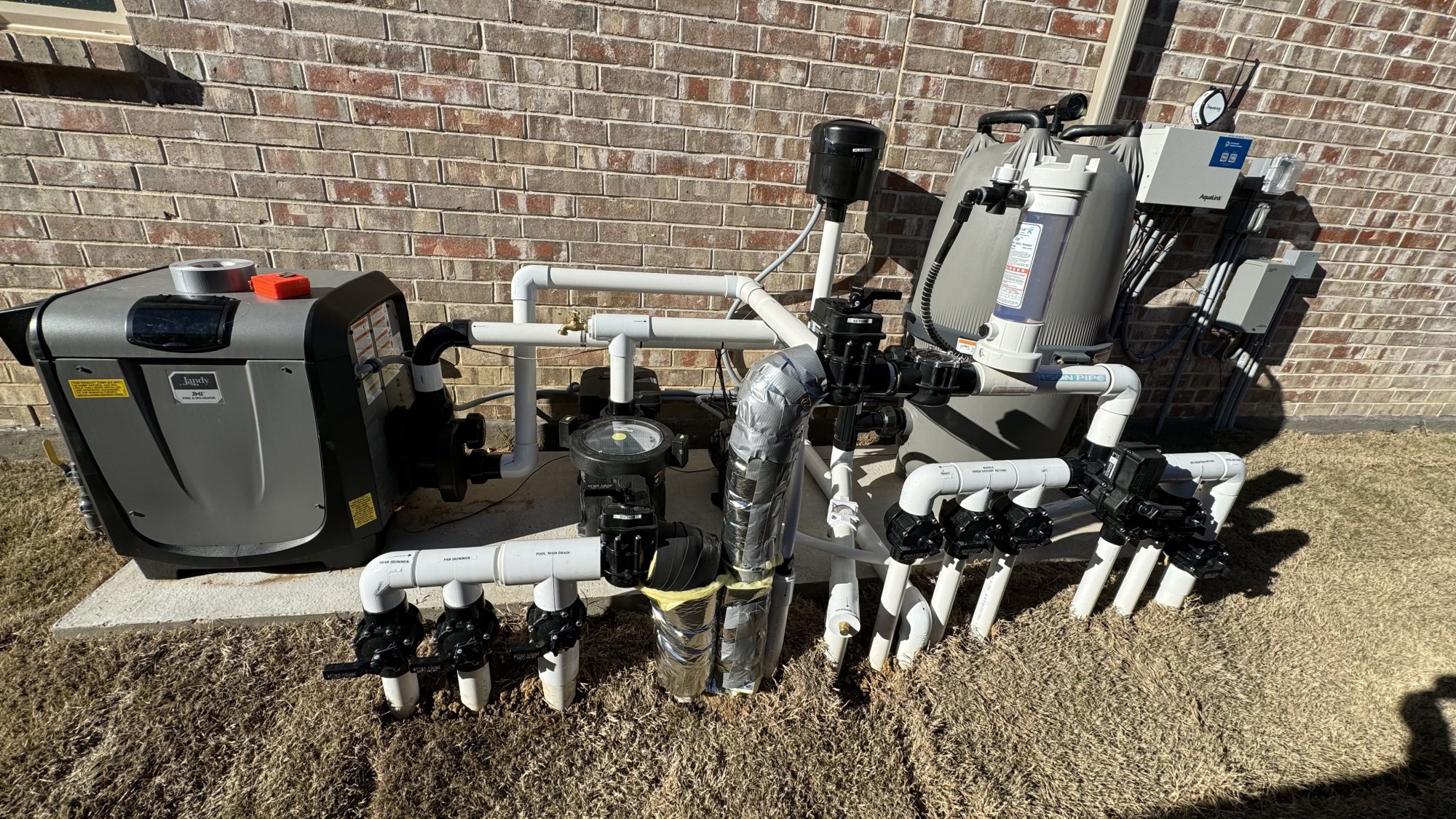

Eeeek! Still running, but lots of ice accumulation. Highs won't get above freezing for another two days. Any advice other than try to knock off the ice?
With that setup, I would have drained the water features and shut them off instead of running water through them.
Do you not normally close in winter?

Thanks for sharing strategy and learning back here! I wanted to share what I finally decided to do and how it's working out so far:
  • Decided to isolate and blow out my sheer decent lines with an air compressor and then remove them from feeeze protection. Set the automated valve switch to off and completely closed the path to them. I'm sure not all of the water is flushed but 80%+ is and what's left should be settled in the lowest point of the plumbing under the pool safe from freezing. This aleviated my worry about ice building up on the wall where they flow.
  • Spa was not included in freeze protection but I did manually open the return valve enough to get some flow.
  • I chose not to partially open suction from the spa as I had pulled the lid on the pump with the valve open to create a bit of space in the line so taking that risk.
  • Wrapped the heater and filter in one of these as they are on opposite ends of my pad.
  • Carefully placed a heat lamp, a few drop lights and a small space heater on the pad under the tarp.
  • Covered the plumbing the best I could with a few old sleeping bags
  • Tripled checked that nothing was getting too hot every 30mins until I was comfortable that things were safe.
So far the air temp has hovered around 13/14 F where I love and the temp sensor under the tarp on the concrete pad is reading ~34. As long as I don't loose power, I'm feeling as good as I can.
