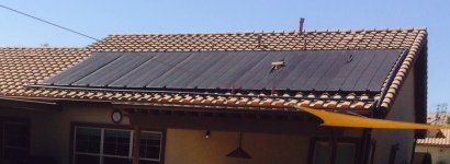

When I installed my solar panels, I used a great tip I found in the instructions I was using (off the 'net). They recommended rotating the panels a slight amount, such that they didn't run exactly parallel to the ridge of the roof. In addition to the small vertical tubes sloping downhill (due to the slope of the roof), this skew of the panels makes the horizontal manifolds slope slightly downhill, too. I put the same skew into all the pipes running to and from the panels, as well. So when my pump shuts down, my panels drain completely, and no water gets trapped at one end of the panels or the pipes.
Without this skew, I'd be concerned about the water left in the panels, and would maybe try blowing them out. If you think your panels might be trapping water, that's something to consider. A small layer of water in the bottom of the manifolds or pipes shouldn't be an issue, only if you think a pipe or manifold remains mostly full.
That said, I agree with the others above. "Winterize" your panels by draining them the best you can and run water for freeze protection only through the rest of your plumbing.
You can almost make out the skew of my panels relative to the roof tiles, but it's there. The skew is more obvious in the supply pipe just below the panels. While this skew works well for draining, it also serves a more important function. Because of the skew, my panels fill from the lower left and then the water exits from the upper right. The skew ensures that no water or air lingers in the upper left or lower right corners, which would impact the heating efficiency. There are some great animations on this webpage that explain this better:
I doubt there is much to be done about this now, though it's possible if you were very ambitious. But if you ever replace your panels, or install them on the next home, keep this in mind.
