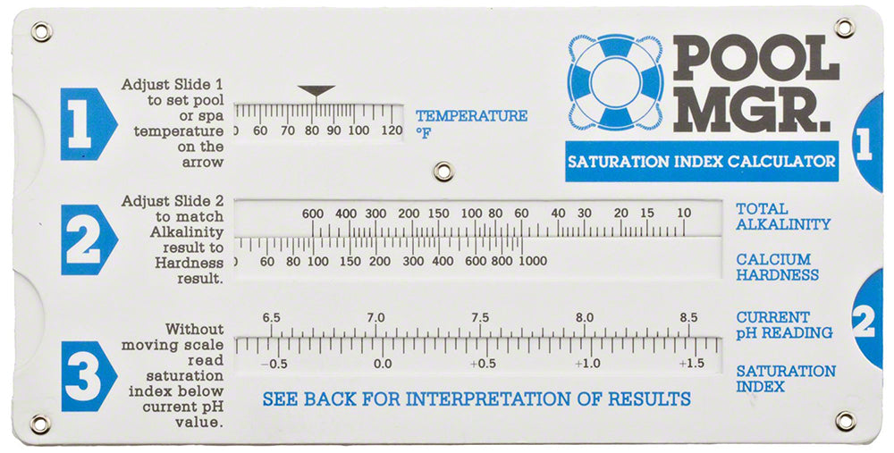

I have found if you take the time to fully understand the chemistry and how the different tests interact to make the saturation level, it will become easier. For example, my CH is 400, due to my well water. My TA always wants to stay low. After fighting it for a season I decided to let the TA stay lower which helps keeps the pool balanced at close to zero, when the PH is around 7.5. The color Q came with a really neat slide ruler to check water balance/saturation. The TFP app does the same thing, but for me just playing with the slide rule lets you see how the tests interact with each other . The more CH goes up the lower TA or PH need to be. Here is a link to the slide chart. I am sure there are others, but this is the one I ended up with. Fun to play with.....at least to old school people like me.
Reactions: HermanTX
I don’t worry about my saturation level because vinyl. But I do change numbers on the app to see what would happen to it. Like my calcium is 50ppm which is pretty much non existent. I’ll put in 500 just for fun to see how much it changes. Than 5000. Than fool with the other numbers to see how the saturation number reacts. Lol. Calcium at 5000 I’d raise the water level dumping 1200 pounds in btw. Probably get put on a FBI watch list too.
