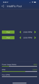

Also just realized I was messing in the app today. And I think I clicked something in the pump section. This used to say Pool on the top and Spa on the bottom. Now it says Pool and Pool.

So I think i just fixed it. In my exploring all this new equipment i think i messed up a configuration at the easy touch panel. In settings under PUMP #1, there are 1-8 for settings and i think i had tinkered too much and accidentally reversed or altered the 1/8 being the pool pump setting and the 2/8 being the spa setting.
I think i shut off the spa setting and changed 1/8 to Pool/Spa. Anyway I set them back and now everything seems to work right.
Honestly though i feel more like i got lucky here so if anyone has anymore info as to how i both screwed it up as well as fixed it, i would greatly appreciate it. Thanks!!
