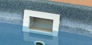

I’m sorry—one more question! These two round things at the bottom (they’re in the deep end) are drains, right? Are they supposed to send water back to the pump? When I put my hand up to them, there’s no suction at all.
Thank you!
Erin,
It is almost impossible to feel any flow through the main drains.. You will not be able to feel it with your hand.
If you know which valve controls the skimmer, shut the skimmer off and make sure the other valve is open.. If the pump continues to run and has water, you can assume the main drains are working just fine.
