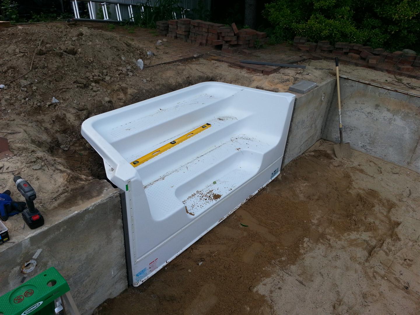

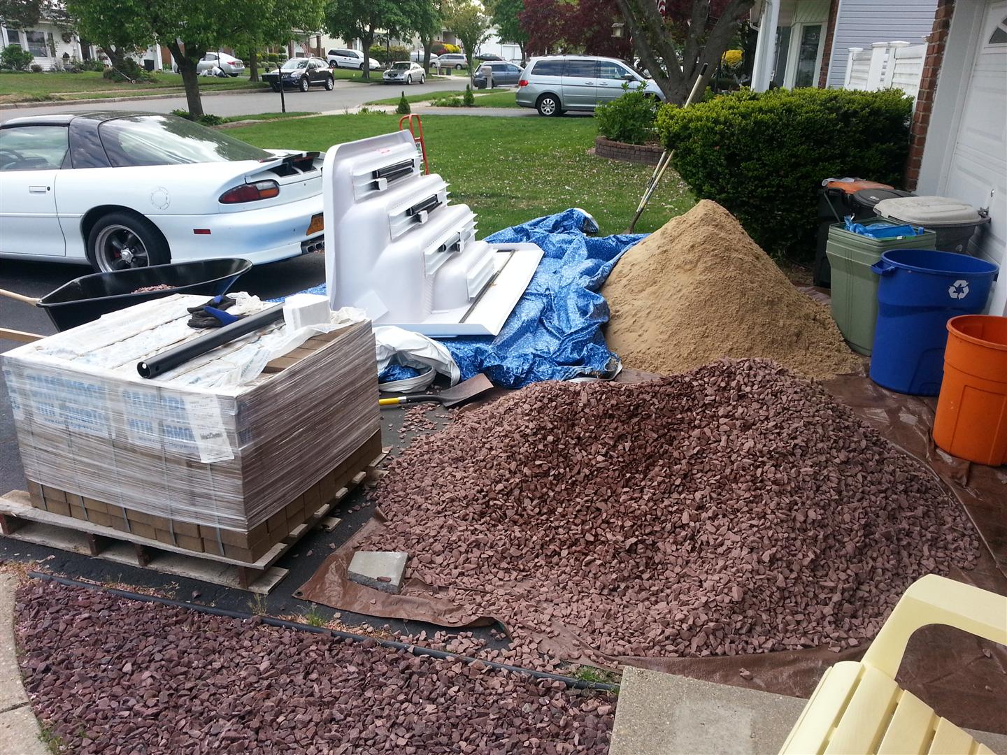

Got a few deliveries today. Got a pallet of pavers, a yard of crushed 3/4 red stone for the front beds, and a yard of fine mason's sand to regrade the pool. We also got our new pool stairs in. The bill of lading read 293 Lbs, but half of that must have been the pallets and packaging.

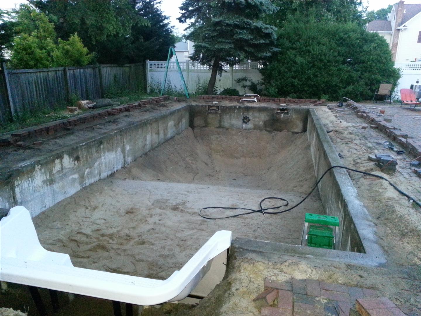

With the help of my family, we were able to take down the four questionable trees, dig out the old steps, and drop the new steps into the shallow end. My poor dad and brother Dave both managed to injur their backs wrestlin' the trees around.
New steps are in place. What an improvement over the old ones.

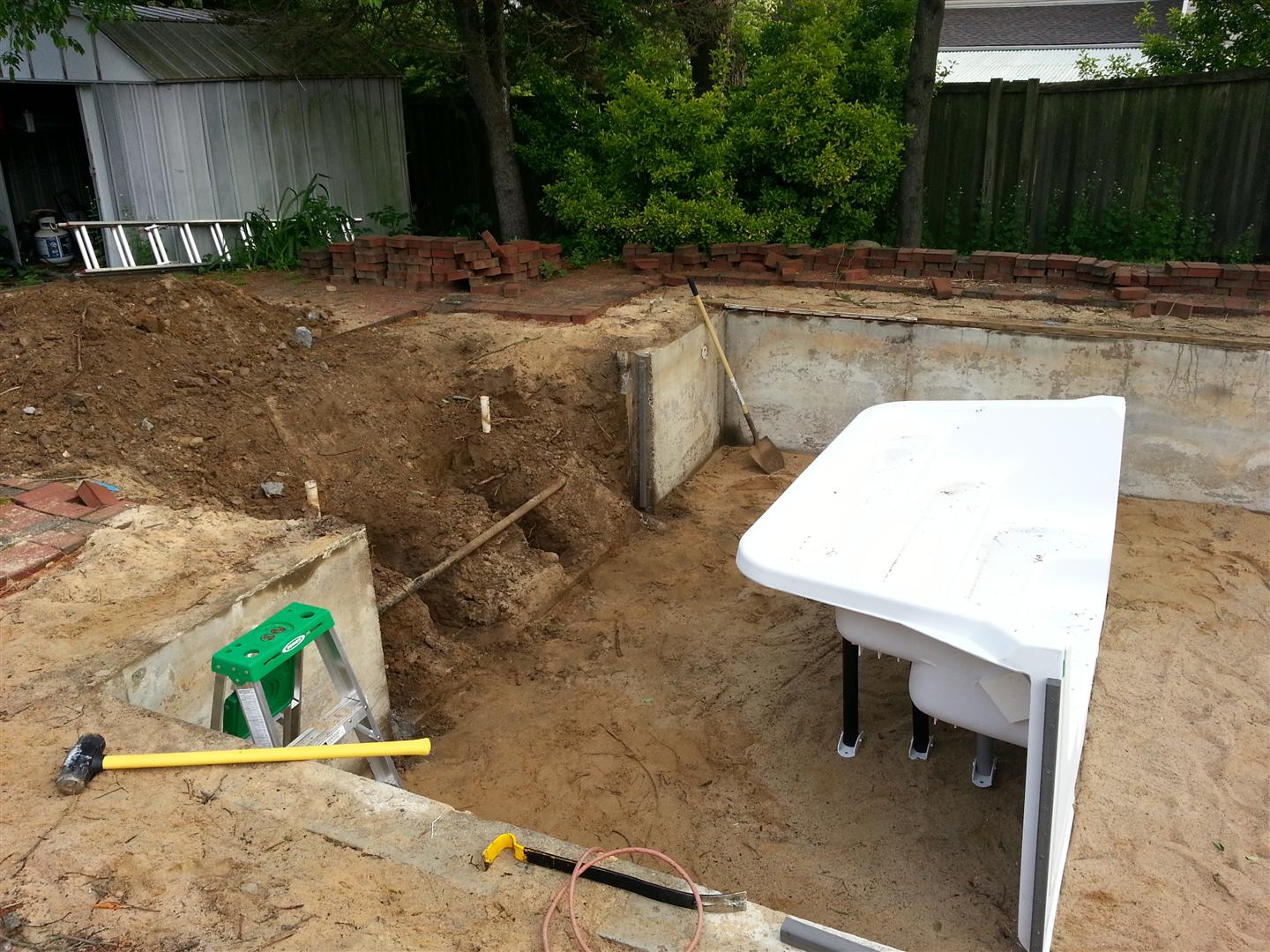

Since I couldnt get underneath the stairs without moving an unthinkable amount of dirt, we decided to use composite decking ballusters to secure the stairs to the sides. For each side, we screwed one 2x2 to the stairs, then drilled and screwed another 2x2 to the cement walls. Once we slid the stairs into place, we face screwed the two ballusters together. Seems pretty secure so far.

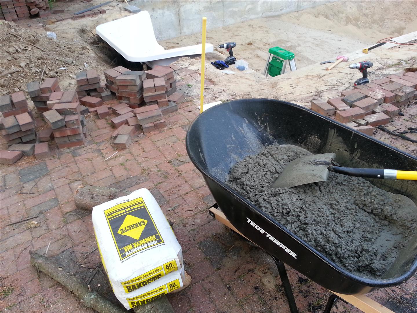

Here we are mixing the "Concreto" to set the six support legs in under the stairs.
The stairs are secured and cemented in. We pulled the remaining 2x6 from the top of the concrete walls. I'm nearly done cutting down any remaining nails still protruding from the walls. We are ready to start laying the concrete block. Notice the trees to the left are no longer standing.

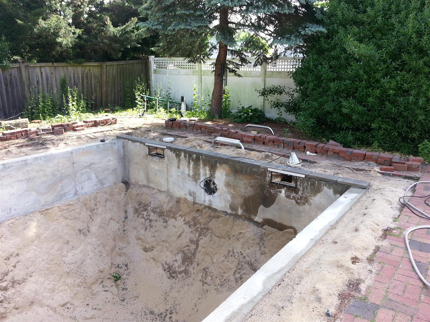

Now here's another question. I noticed some chalky white substance on top of the concrete walls, primarily in the shallow end. I thought it might be paint, but as I was grinding it off last night, I think it might be limestone leaching up from the concrete, or possibly from when it was first poured. Its soft enough so that I can scratch it easily with a screwdriver. I plan to wire brush off as much as I can. Any idea what it might be?
Re: DIY inground rehab, vinyl liner over poured cement walls
efflorescence probably. Water gets behind the block and dissolves minerals and pushes them to the surface where they precipitate.
If you ignore them, they can get difficult. Wire brushing as they appear is best. It can also travel through the grout of finish tile.
It may not be that because that process never goes up but, rather, travels horizontally.
Well I dont see the usual metallic sheen of effloresence that you see in basements or on a boiler. But i know what you mean. It does seem almost like the limestone separates and worked itself up to the top. But if it took 30 years to get that bad, Im not too worried. Im sure a good wire brushing will be all I need.

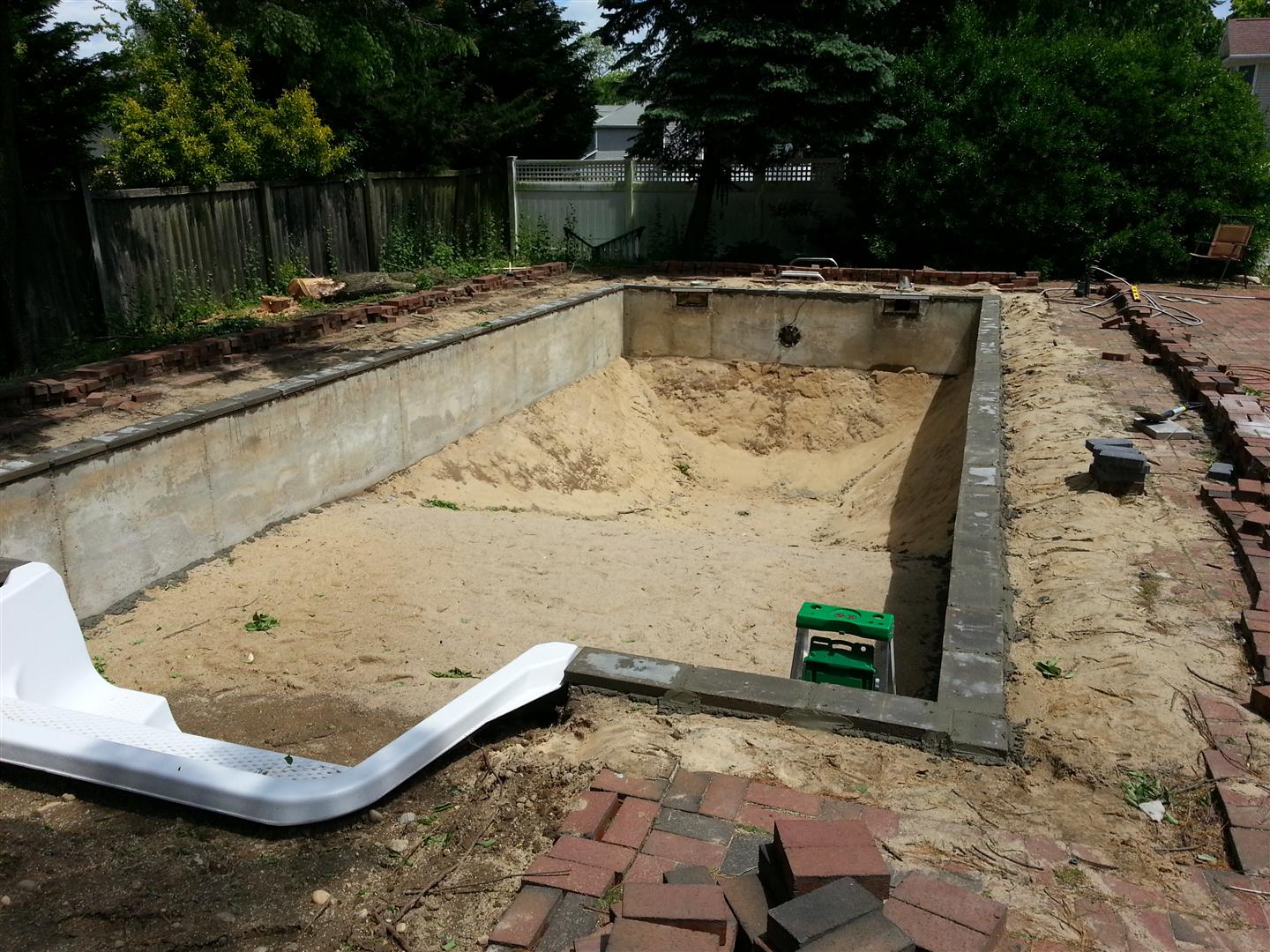

The first few concrete blocks go down at the deep end of the pool. We cut four 2-foot lintels out of 1/8 aluminum stock to help support the block above the skimmer.
500+ pounds of mortar later, and we have the concrete block down. We coated the existing walls with a slurry of mortar and concrete adhesion additive to help the bond to the 30 year old concrete. It all seems pretty solid, thoug things could stand to be a little straigher and more level. If I were to do it over, I would probably just use thinset between the walls and block, that way things woudl have been a little more level.

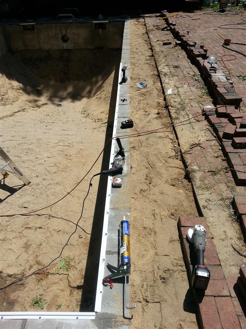

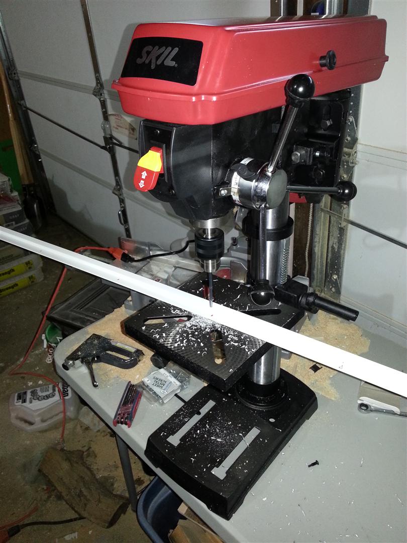

Ive been looking for an excuse to finally put my mini drill press together, but I never had anything to drill. That changed this past week when I pre drilled each 8 foot section of liner track every 8 inches. This made installing the track so much faster, since metal drills dont like drilling through concrete, and masonry drills dont like drilling through metal.
The aluminum liner track starts going in. We used liquid nails between the track and the concrete block, then we sunk in masonry screws every 8 inches. Finally put that hammer drill to good use, and I'm proud to sya I didnt break a single bit this time.
All the liner track is in place. Its not very straight, both side to side, as well as vertically, thanks to my very poor job laying teh concrete block. I did my best to shim the track using miscelaneous pennies, nickles and dimes, but there is still a bit of visable runout. Im going to have to do a bangup job on the coping to try and redeem myself and make things look a little more straight.
I really wish things had turned out a little straighter than they are. I really didnt like the way the concrete block turned out. Whats more, in my haste, I put the block overlapping the wall by about 3/8 inch to try and replicate the location of the liner track when there was a wood beam instead (nailed to side of wood instead of top). Had I re-measured before laying the block, I would have refrained from adding any overhand to the side walls since the walls were exactly 16' which is how I ordered the liner. I got so caught up in recreating the location of the liner track, I simply didn't consider that the new liner is based off my wall measurements. I'm sure Ill be able to make up 3/8 on each side, especially since the stairs cutout will let me take in or let out liner bead as necessary. Live and learn.
