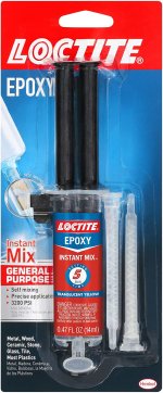

I removed my diving board and have drilled the studs down below the deck surface. A few posts here say to fill with epoxy. Just want to check before I go further, do I just use any regular two part epoxy? Something like this ...81EMsK7piZS._AC_SX679_.jpg
Given the condition of the concrete, I wouldn't trust it with the forces on a dive board. Typically, the studs/bolts/fasteners need to extend about 6" into sound concrete to be safe.
looks like the holes are only going to be filled, doesn't need to be structural...other than to hold a small plug/patch in place.
There's a self-leveling sealant by Sikaflex that I think would work perfectly. It's a rubbery sealant for horizontal surfaces only (it'll drip down vertical cracks), it's kind of messy, it'll skin over in 2-3 hours and fully cure (firm/flexible) after a couple/few days.
Make sure it says Self Leveling. It looks like the 10.x oz tubes are available, I've only bought the larger tubes of it.
Check the colors too - there's a few different colors from gray, sandstone, black, etc.
