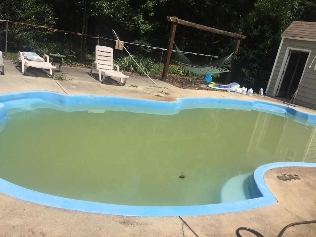

Unfortunately, your swamp was just too much to turn around in a few days. I will say you have helped me by being another data point that will help me have a better idea when to tell a new person, "look the SLAM could work in time, but you know what, in this exact situation, you may have better odds having a pool for your party if you do a siphon vac/sub pump/trash pump and throw away your bottom 12-48 inches of water and refill, then SLAM as diligently as humanly possible - every hour counts, so wither SLAM asap or drain asap then slam - either way, no one in the world can guarantee this will be enough time to guarantee a sanitary pool, too many variables."
I hope the silver lining is that you see the value in maintaining the correct FC for your current CYA and preventing green from every troubling you again and having to use the pool store magic potions - even the ones that seemed very helpful in the past - if their expenses and risks can be avoided now, why not right? The pictures prove you're on the right track, no doubt at all. You might want to print them and show your guests how the water is improving everyday, and you are assured victory, and it will be crystal for the next party! In the mean time - I wish you the best in your party prep, delicious food, good conversation, and good times.
Kudos for getting the pool not losing much FC in 4 hours, that's a major improvement! You'll see the color improve faster and faster!

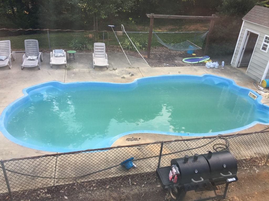

Well, guys. Still working on this pool. Color is MUCH better than last week, clarity is improving, but still not where it needs to be!
Updated levels:
TA 90
pH 7.0
CYA 60
CH 70
FC 13
CC 0.5
Updated photo.
Just added 211 oz of 10% bleach. I continue to brush/vacuum at least once daily. I think I'm still on the right track, but MAN is this taking FOREVER! I've never had so much trouble opening our pool. I have tried the "magic paper towel" trick (putting paper towels in the skimmer) with some success. Not sure if there is something I'm missing. Once this pool is open, that first dip is going to feel sooooooooo good!
Thanks for the help as always!

Ahh now that is some beautiful progress!!!! Thank you for staying the course! I know you'll probably keep it clear once you finish, but I suggest people to make a note how long it takes your pump to clear a swamp, you know, in case you ever get tempted to let it go again.
Now that the pool is normal looking, I can see the awesome grill/smoker, the chairs, the hammock, and a really fun back yard all around! Amazing what a difference green to blue makes!

Pictures are clear, but to my eye/lighting, I wasn't able to tell if it was just cloudier or actually greener. What does it look like to you?

We did have a pretty decent rainstorm and my bleach is kept outside, but other than that, no changes that you listed. It is definitely greener. Clarity isn't that much different, maybe slightly more cloudy, but not too much.
