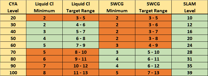

Set the SWG to 30% and leave it and the pump running 24/7.
Adjust percentage up or down as needed to stay near the upper side of target range for your CYA.
A little over or under top end of target range is fine.
Trying to set the SWG to make up a 1ppm average loss and maintain that will drive you crazy.
Don't try to micro-manage the FC level.
If set at 30% - 24/7 and the FC continues to drop, add liquid chlorine to get to the top of the target range and then adjust the SWG up another 10%.
If set at 30% - 24/7 and the FC climbs, adjust the SWG down 10%.
Continue these adjustments, reducing the percent change each time, until you can consistently maintain FC within the target range - preferably the higher side of target range.

Since 30% still results in a loss, set the SWG to 35% or 40% - see post #4.
What is your CYA?
Run FC at high end of target for your CYA.
With a clean filter, what is the minimum RPM (don't be conferned about flow rate) you can run the pump and also satisfy the SWG flow switch?
Once you know that RPM (with a clean filter), add 200 RPM to that and use it as your minimum RPM.

A CYA of 50 should get you thru the winter just fine. Raise it to 70 in the spring when the temps increase.
As to the FC burn off at higher FC levels - yes, it will burn off SLIGHTLY fast, but at only a few ppm higher you won't really notice it.
Always shoot for top end of target range for your CYA.
