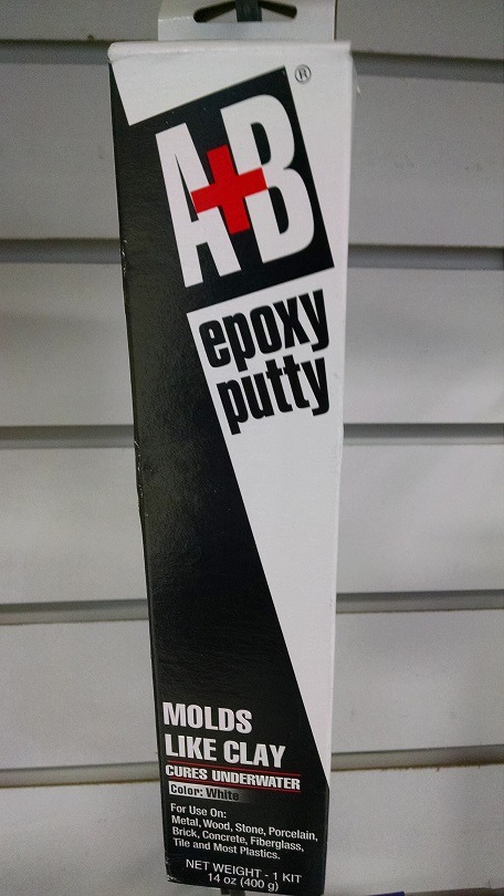

You might try some epoxy on that crack. I can't quite tell from the pic, but hopefully you can get enough epoxy on it to where it doesn't interfere with your diverter valve. Below is just one example, but others may reply with other product ideas.

Local pool store recommended the A+B, just finished applying it. Doesn’t look too bad? Supposed to take 1 hour to cure so we will see how it holds up. Appreciate all the help :)
