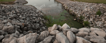

looks like all the water runoff on the pool deck, your house and above your house all go down this hill that the equipment pad is on.. all that runoff is taking away the soil little by little... You need to do build up that whole area with rocks like they do when they have runoff on roads or bridges or anything like that..
See how they have done this for runoff, you will need big and small rocks to fill in the area so it no longer takes dirt out and the rocks slow the runoff down.. you will also need gravel to fill in the area behind your pump pad and in front of it to stop the dirt from eroding then install the bigger rocks on top of that...
