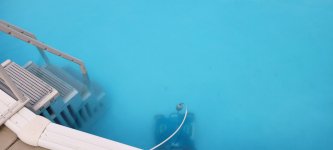

Can you remove that set of steps? It should be inspected to see if algae is inside that isn't getting scrubbed out. If not you'll need to do your best with some kind of wire bristle brush with nylon bristles and scrub as best you can inside those side slits.
I can remove the steps. I will clean them again. I may have just missed something.

I suspect the steps as a contributor - you have to clean them inside & out with bleach. Some have found a pressure washer helpful for getting inside them
