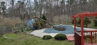

I'll try this and report back once the pool is up and running in about a week. Still dealing with the fallout from this.
