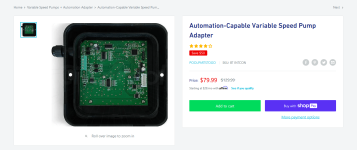

I had the same problem last week. They've been on back order quite a while and no eta can be confirmed. Don't know if this is important to you but the 3 lower priced pumps will all interface with automation using an interface like the one below. Blue Torrent and Calimar do with an 80$ add-on but Blue Torrent didn't have the large pump. Black and Decker appears to be available and works with the automation adapter. It's also considerably cheaper. Important thing to remember is the automation adapter provides digital inputs not RS485. For my case I was looking for a 1.5 hp pump that's not much cheaper than a major brand so I went with a Pentair VS pump.

I had the same problem last week. They've been on back order quite a while and no eta can be confirmed. Don't know if this is important too you but the 3 lower priced pumps will all interface with automation using an interface like the one below. Blue Torrent and Calimar do with an 80$ add-on but Blue Torrent didn't have the large pump. Black and Decker appears to be available and works with the automation adapter. It's also considerably cheaper. Important thing to remember is the automation adapter provides digital inputs not RS485. For my case I was looking for a 1.5 hp pump that's not much cheaper than a major brand so I went with a Pentair VS pump.

Here's the same adapter at a better price. $80 worth of fun for $35...
