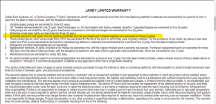

File a warranty claim.
Complete electronic salt water chlorine systems (controller and cell purchased and installed together) are warranted for three (3) years.
Thank you. This was definitely going to be something I checked when I got home from work. I was on my train commute while writing this post and was anxious to get started on troubleshooting. This is greatly appreciated information. Thanks.
