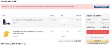

1 week into construction of a ~26K gallon gunite pool and need to make a decision on my salt water system. PB works with Hayward and intends to install a Aquarite 940 salt cell (this one, I think.)
I know there is a sale on Circupool SWGs and wonder if I should buy this one instead.
I see: "The RJ PLUS-Series will replace Hayward® Aqua Rite® systems with no cutting or gluing, making it a snap to upgrade your salt pool system!"
PB says "no problem", but reminds me the Hayward carries a 3year parts/labor warranty. If I want the Circupool, they'll credit me the cost of the Hayward (waiting to hear how much $$$) and I can order it myself.
I'm in the DFW area.
Opinions?
