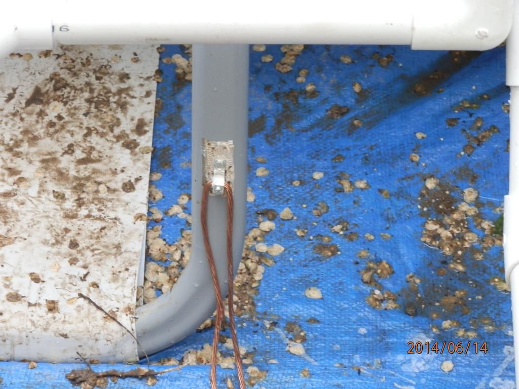

Great build! With a five year old, you will get so many great years from it that the sticker-shock will quickly wear off. I am curious, since you mentioned having inspector-types involved even though it is a "temporary pool": What have they said about how to properly bond one of these pools? I, too, have a rectangular Intex (actual Intex). On the Intex, the metal supports snap into each other and at each juncture is a plastic component -- I've never been clear on if that means the bonding loop is going to be deemed "continuous" or if each segment would need to get a separate lug (that would seem nearly impossible, particularly as I actually do dismantle and re-build each year). Did your inspector determine a way to effectively bond to the frame? Thanks for any input, and congrats on a great project!

As to your question concerning bonding. Although there are varied opinions, and most say it isn’t a requirement on a pool such as this one, with the addition of the upgraded equipment and electric heater we wanted to be sure we were taking any precautions to ensure everyone’s safety.
The electrician installed ground lugs on one upright on each of the four sides of the pool and ran the loop around the perimeter. He did grind off some of the enamel paint before attaching. We are not using a ladder, but he did indicate if we choose to add one, it too would need to be bonded (anything metal within 18’). This is the pic of the upright closest to the equipment.

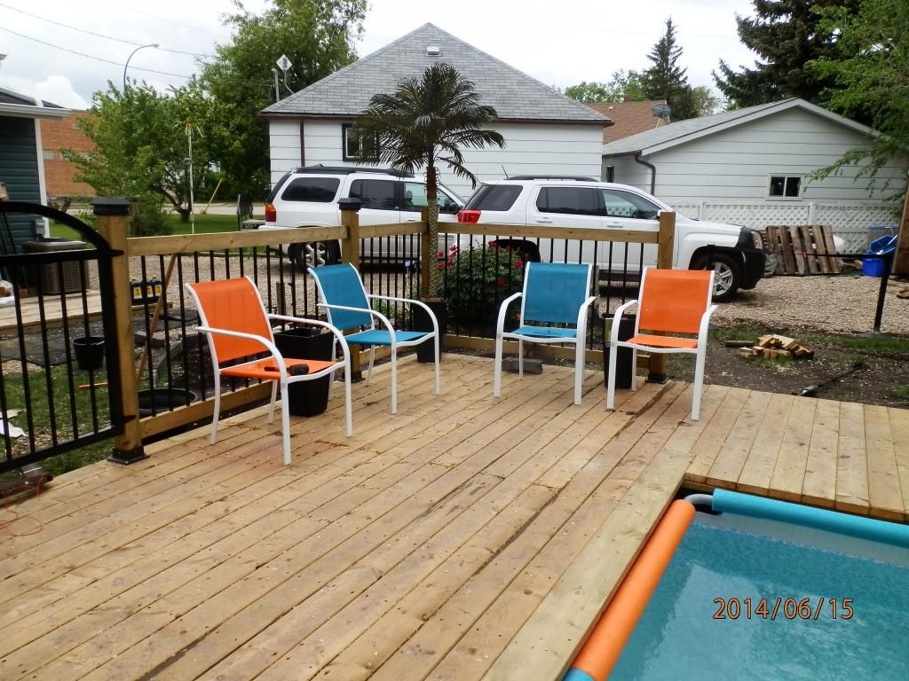

So, alot has happened since yesterday morning. Pool equipment installer completed his repair and the rest of his install. All the equipment is up and running including the heater. With the K-Star10 heater set at the mid point we saw approx. 13 degree increase in temp from 53 to 66 in less than 24 hours (without the benefit of a cover which won't arrive until Wednesday). Hubby has put it up to 75% and we will see how much of a difference it makes. The deck boards are all finished, and as luck would have it, today as we started the last of our deck rail install we realized we were short a couple of deck post anchors, so off the Hardware store (50 miles away) for the hubby while I tackle the pool stairs. Came up with a creative idea to protect the liner from the deck boards and have decided we like the look so much we are going to "pimp" out the whole top rail of our pool as well. The bonus is, we were able to find poolside loungers and chairs to match :) Here is a pic in progress. We still have to trim out the cut ends of the deck boards (to give us a soft edge), but at last we are close to seeing the finish line...
