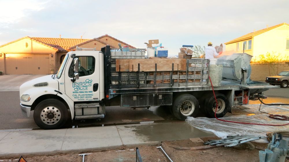

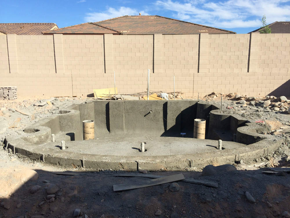

    Shotcrete...
    They placed the pool light too low, it was supposed to be centered in that middle column but they are saying it will be ok, light output won't be affected.

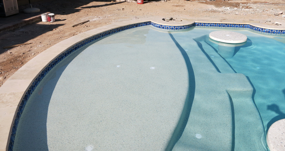

    And it's done!!! It's now filling up with water from the hose (should take about 6 hours I guess) and then they will be back in a couple days for the start-up process! It think with the blue beads in the finish, we should get that nice sparking blue water we're looking for.
    Since last update, they finished the coping, came out and did the PebbleTec BeatCrete surface, then came back out the next day buffed, power washed and acid washed the pool...here are the pics.

    Re: Self Designed Pool Build - Phoenix, AZ
    Well the sun ended up coming out and the pool is full of water so here it is. Water color is nice, though a little bluer would be nice...I'm thinking it will change a little after they do the startup and the chlorine does it's thing?

    As for the color - it looks incredibly blue (and clear) to me for just after the fill, it'll almost certainly get bluer when you add chlorine to it.
