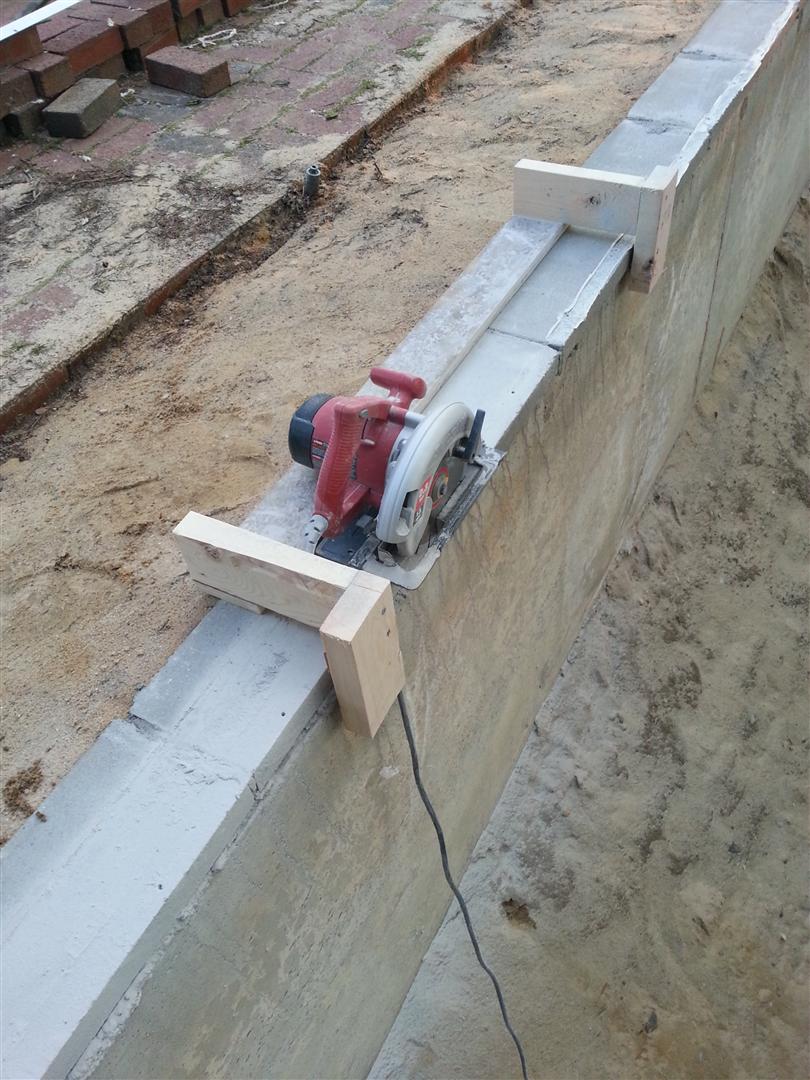

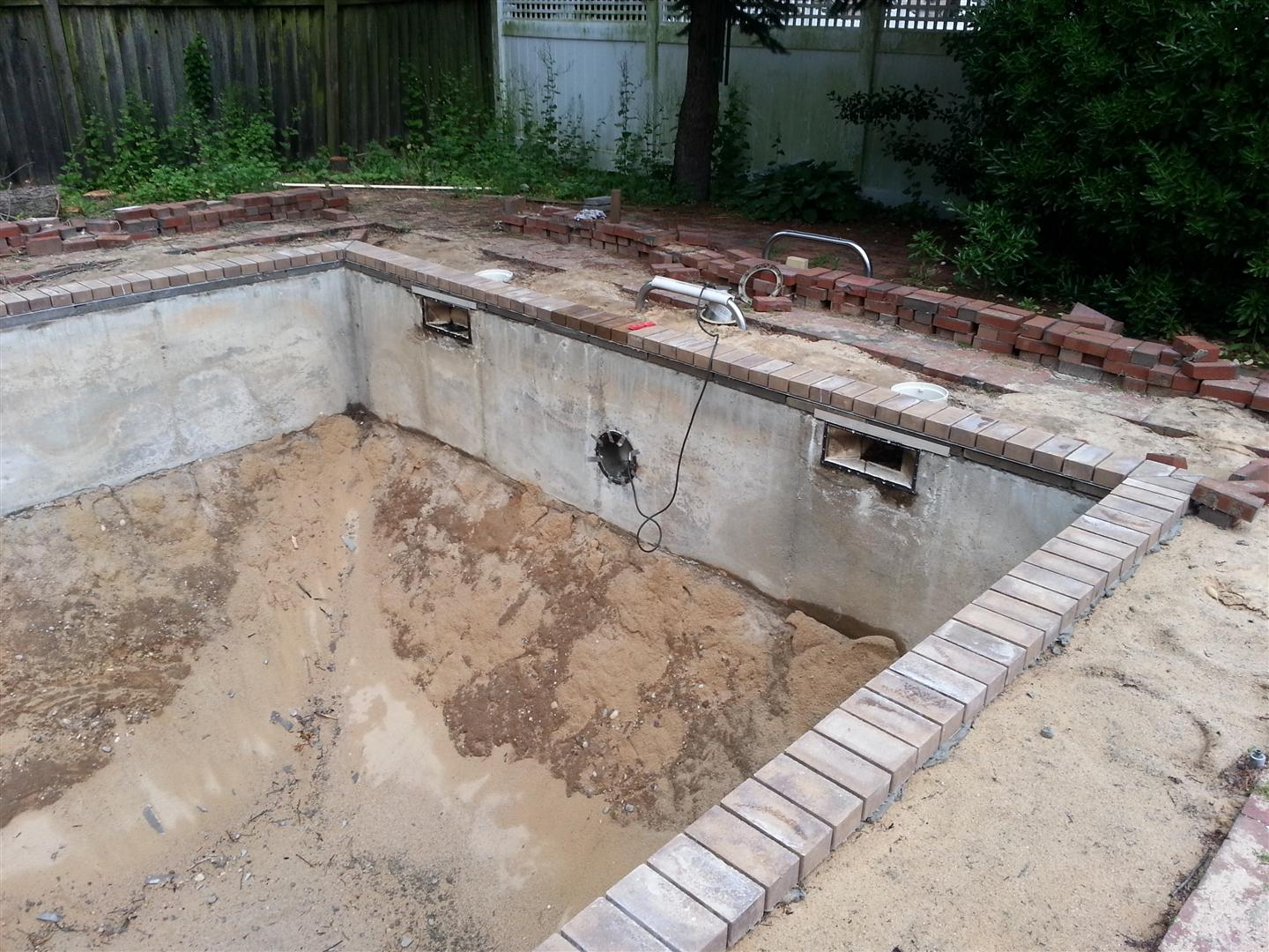

I am aware of the dust factor as well as cutting speed. My concerns are the strength and longevity of the saw since its not a worm drive (15A skil brand), and also how long Ill get out of the diamond blade. I might pick up a couple of segmented blades at HD on my way home tonight. I already have a turbo blade, but I feel the segmented ones might be a better option here. As far as the saw, its relatively disposable. If I need a new one after this, so be it.
Re: DIY inground rehab, vinyl liner over poured cement walls
I don't know if its in your budget, but renting a gas powered saw with a 14" diamond blade for half a day would probably cut it in about 15 minutes and go all the way thru with one cut. My guess would be 60-70 bucks but save a lot of time. I know I used one a ton on my pool.
Actually, what started as a test cut turned into cutting about 10 linear feet in less than ten minutes, with lots of stopping to let the blade cool. My wife stopped me cause I wasnt wearing a mask, and it was getting late anyway. I was easily able to cut through the 1-5/8 thick block in one pass. I just need to make a jig out of some scrap wood to reference the pool walls and allow me to slide the saw up against. With any luck, Ill get all the cement cut by tomorrow night. I would love to be able to lay the vinyl track down by friday night, that way I can screw it down saturday afternoon, but thats a stretch. It still leaves me all day sunday and monday to get a good chunk of the coping layed down.

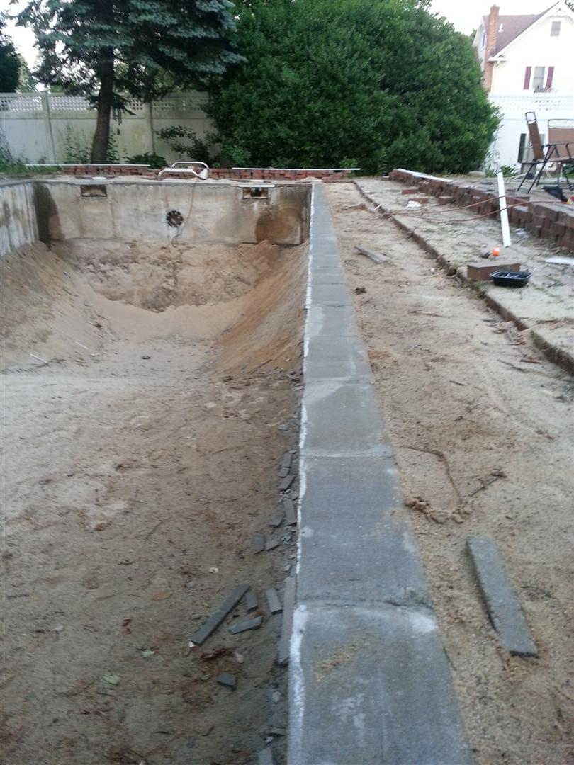

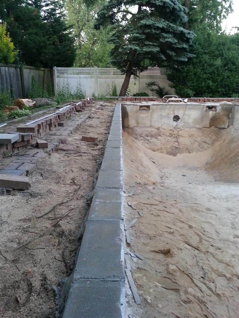

Well, after much deliberation, I decided to pull off the liner track and cut back the concrete cap block flush with the walls. I knew it was going to bother me every time I looked at the pool. Luckily the liquid nails was still soft and the liner track came off easily. Then I threw a diamond blade in the circular saw and quickly fabricated a jig to reference the pool wall below the cap block.
We got the bulk of the two long walls, and the short walls on either side of the stairs cut back. I will leave the overhang by the skimmers since the skimmer protrude a bit anyway. It took just over an hour to cut through roughly 80 linear feet of concrete.
You can see that the walls look much much straighter now. I can live with this.
A few bits remain where I couldnt get the saw into position. Ill address these with the more maneuverable angle grinder, and then a hammer and chisel will take care of any remaining mortar.

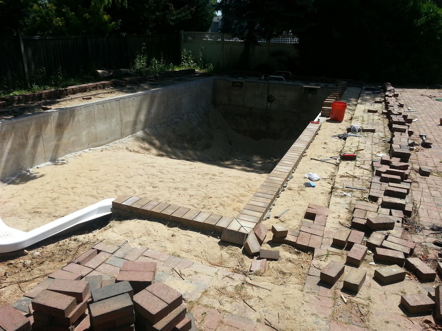

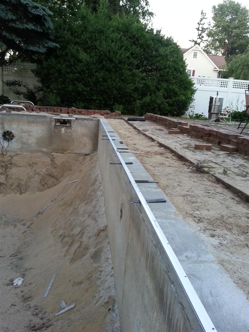

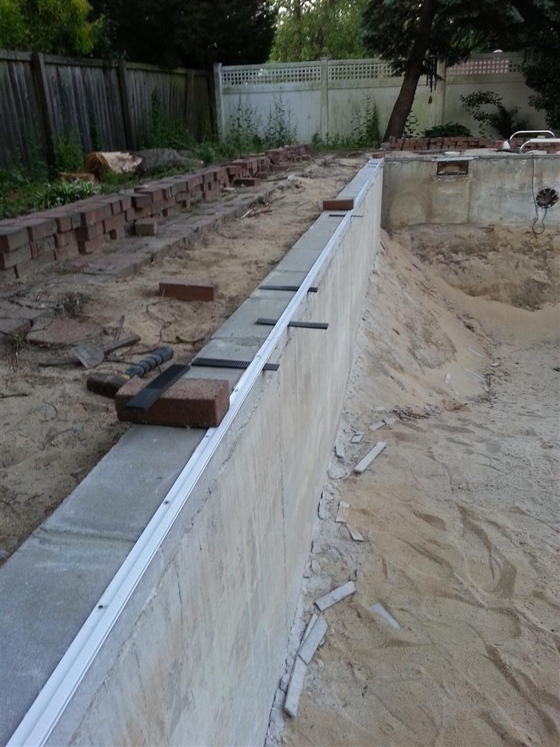

The liner track goes back down. We decided to use polyurethane construction adhesive since it expands slightly to fill gaps, and it sets up and cures much faster than conventional liquid nails.
We used composite shims to level the height of the liner track, ane let the polyurethane construction adhesive fill the gaps. To say the track is considerably straighter than last time would be an understatement. I am very happy we pulled everything apart, cut the block and tried it all again. Much much better.
With the liner track glued, drilled and screwed down again, we can start laying the pavers down to form the pool coping.
We used lated modified thinset (versabond) instead of regular type s mortar. This should create a much stronger bond and have just a hint of flexibility in the wet environment. We mitred the corners by hand with the diamond bladed circular saw.

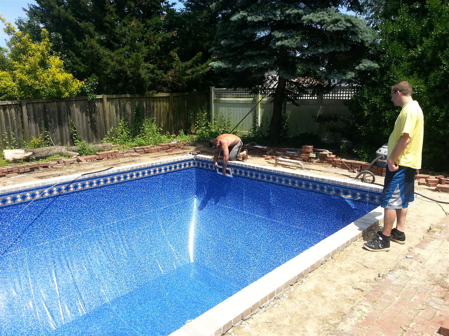

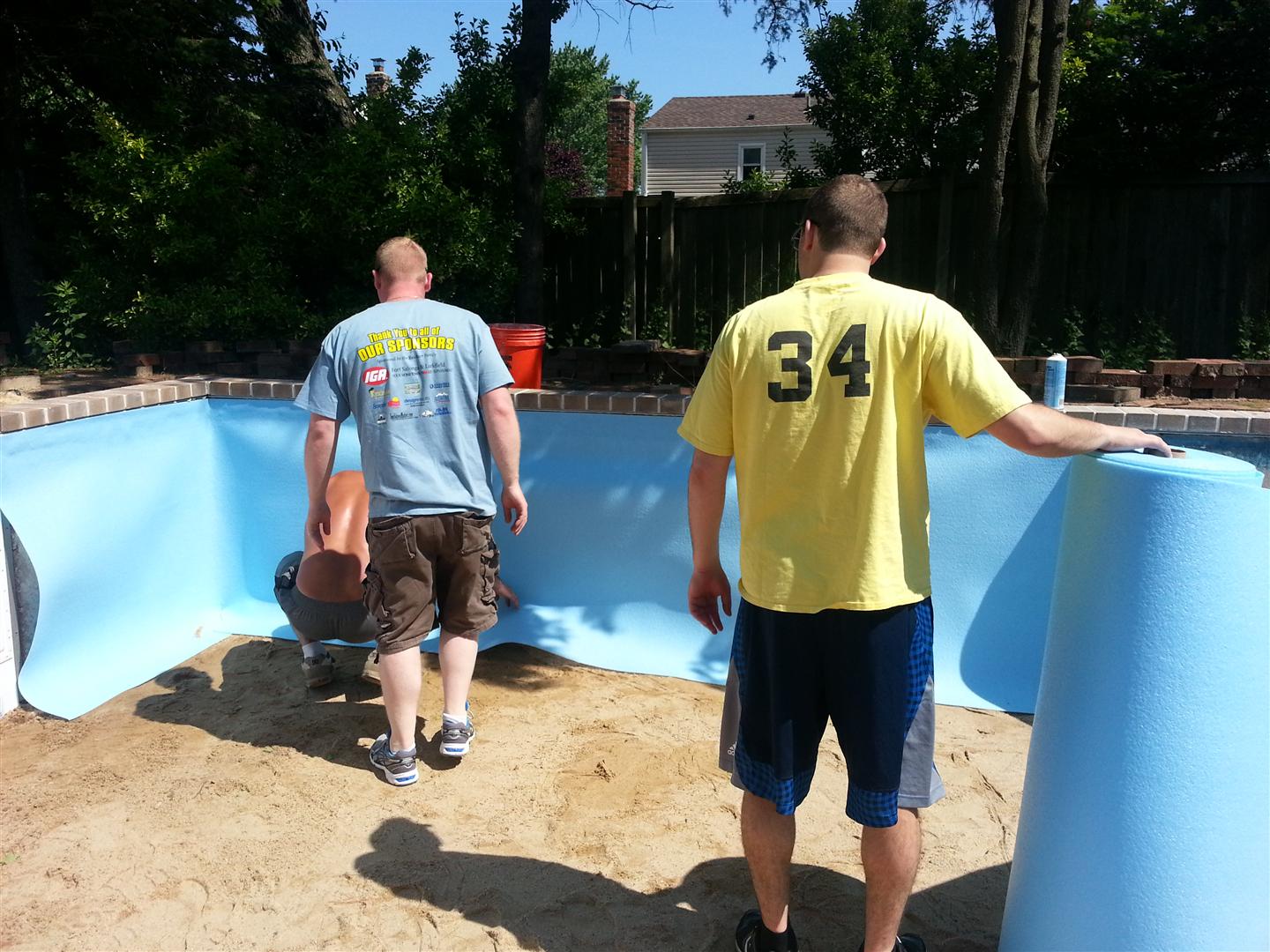

Its Liner Day! Here we are putting the foam up on the walls.

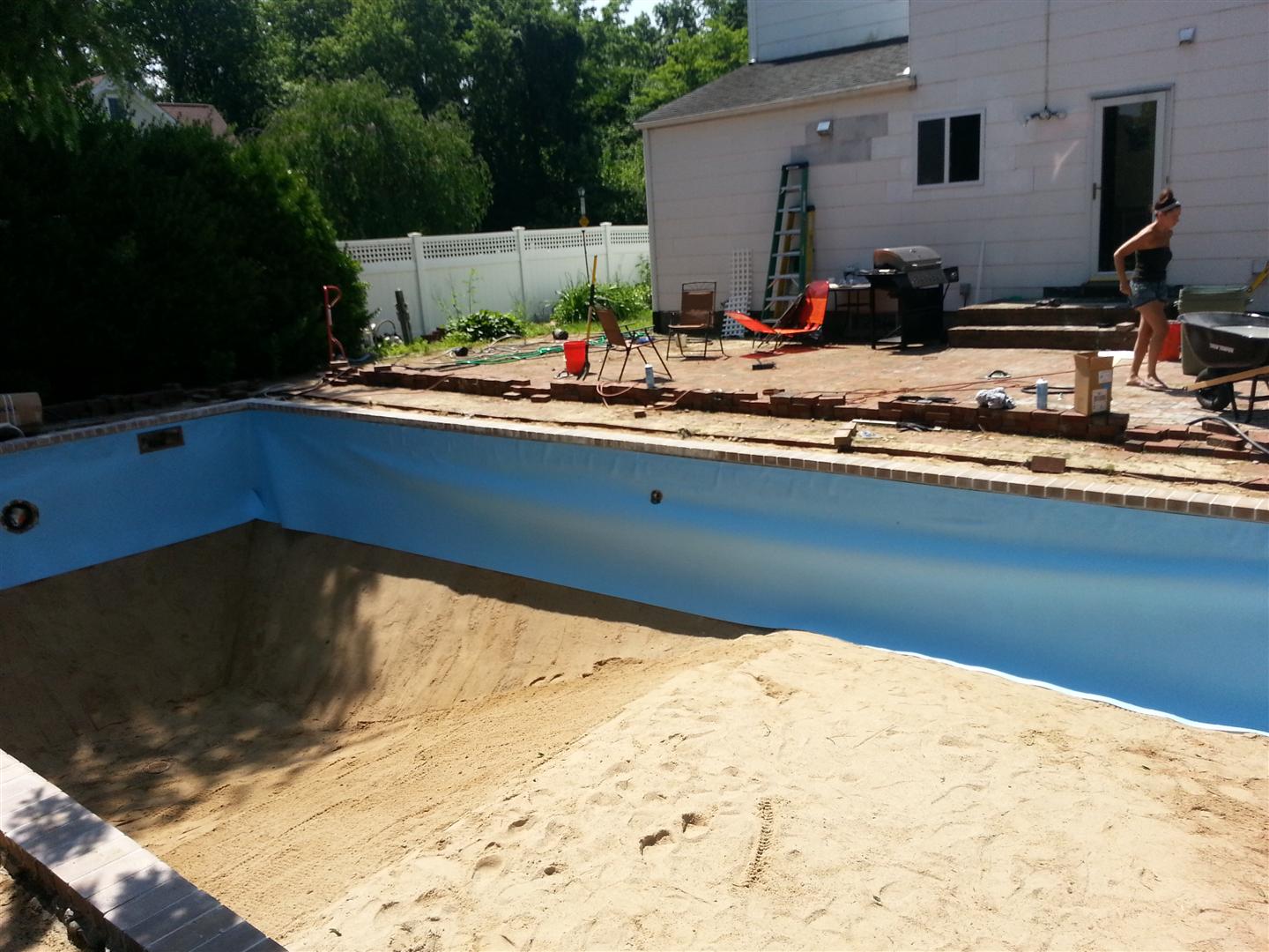

There are a few bunches in the foam, and the grading is not exactly perfect, but I expect nothing more out of a DIY job.

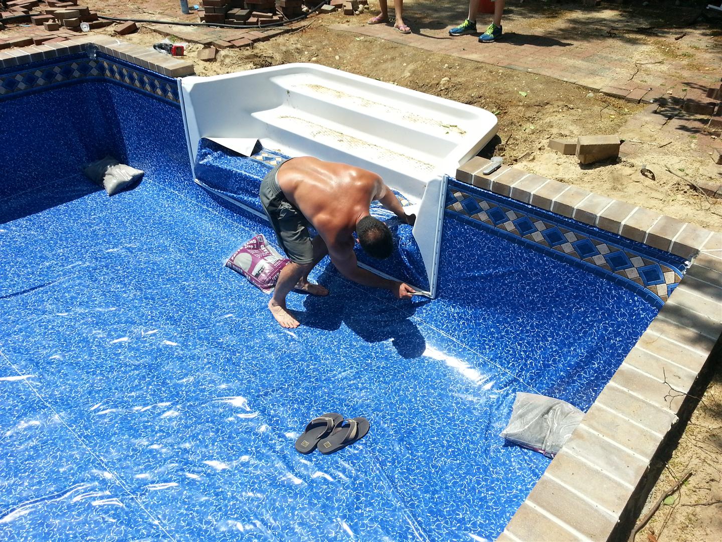

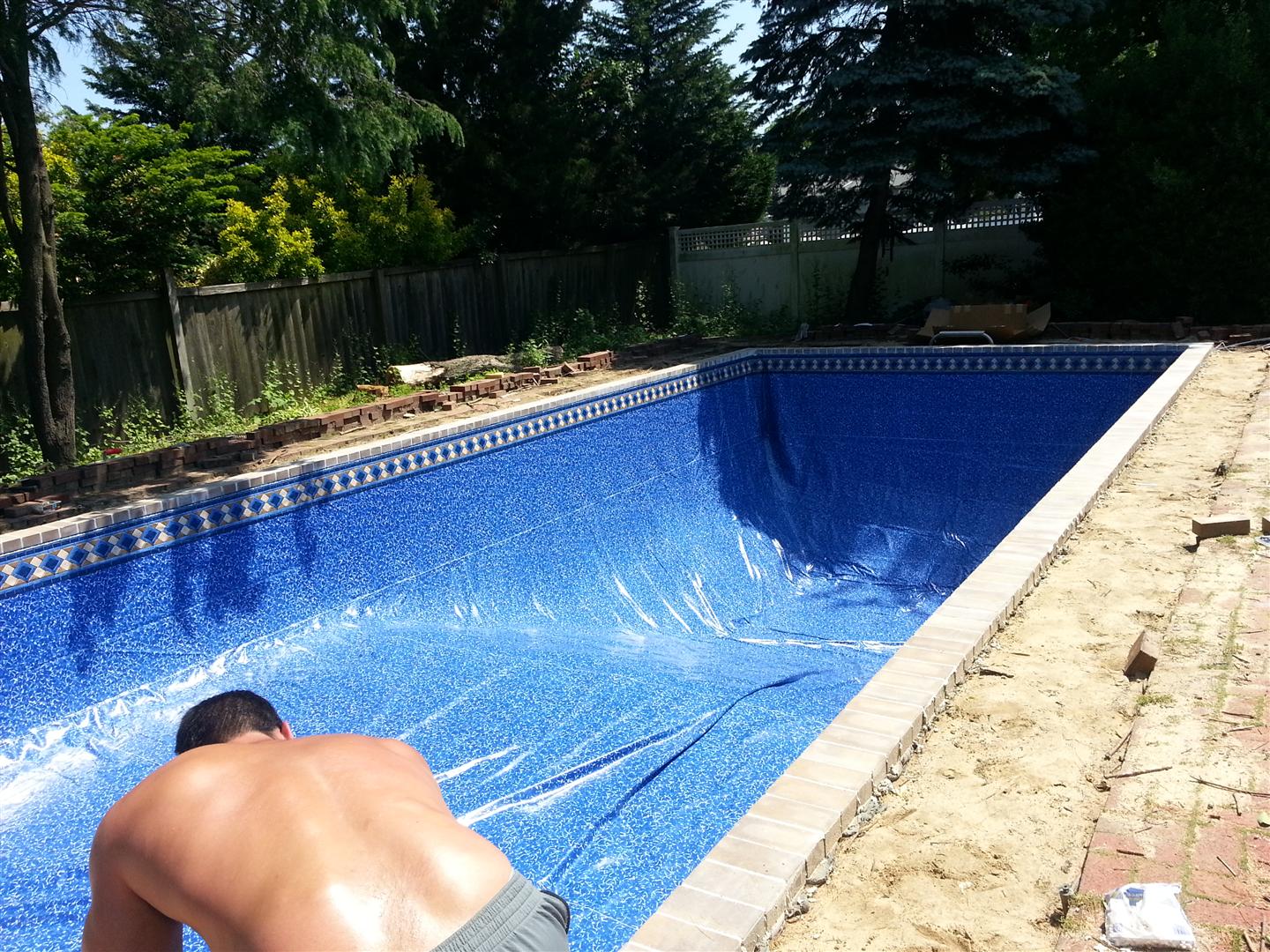

With six guys (including my wife), it was relatively easy to pull the liner over the pool. It took some persuasion to get it into position, but we finally got it in place as best we could. The corners are particularly difficult, since theres no way to actually get the liner bead into the track at the 90 degree angle.

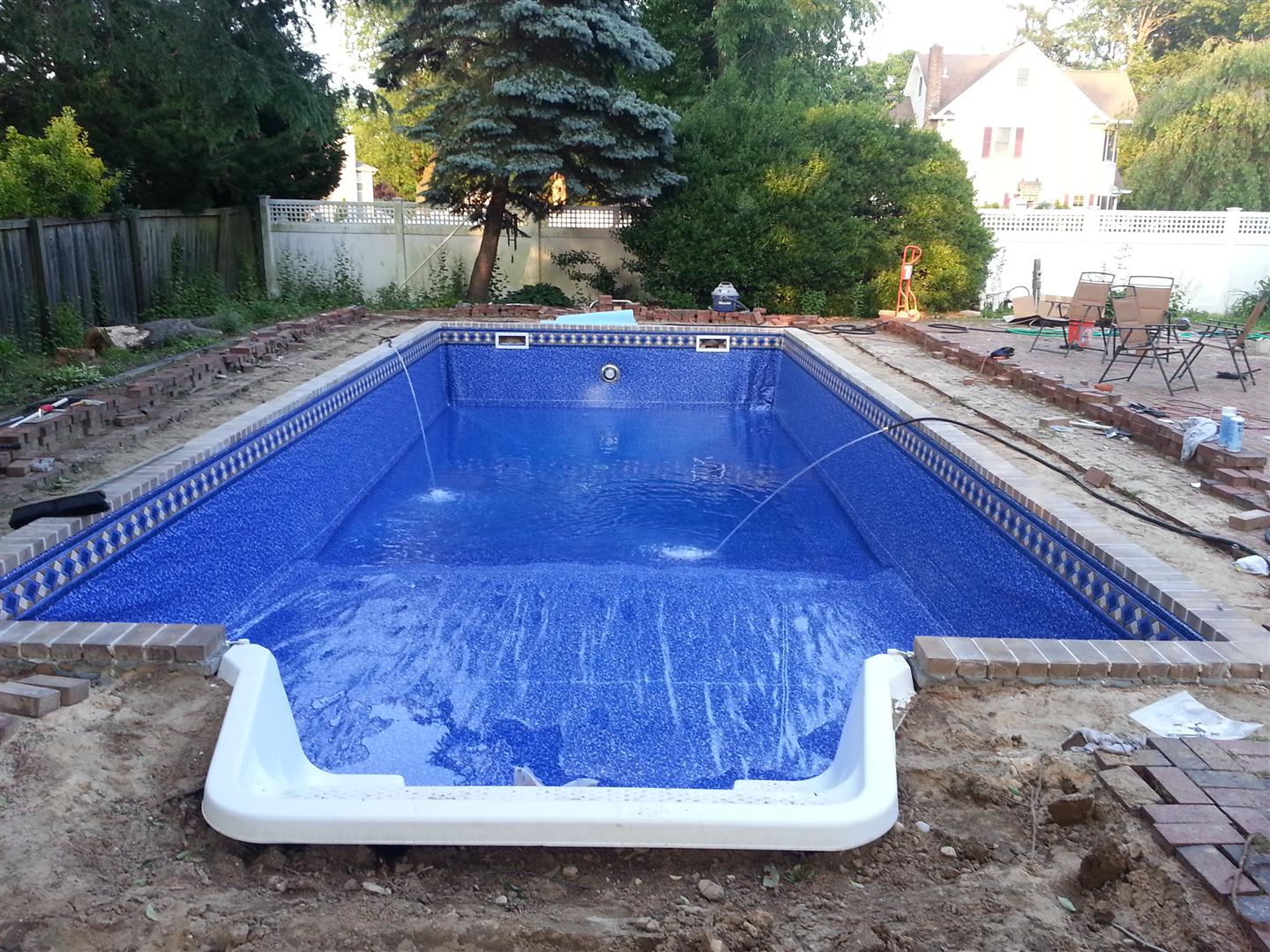

Here I am jumping the gun and cutting in the stairs before the water has come up. I wanted to help create a good vacuum seal, but neglected to realize how much liner would be pulled into the deep end as the pool filled up. I could have used the extra material.
I'm jumping the gun again and cutting in the skimmers a bit early as well, however I have a compelling reason this time. I had to use RTV silicone sealant on the skimmer gaskets since the skimmer wasnt perfectly smooth, and I needed to get the faceplates installed before the sealant cured bumpy without being flattened out by the faceplate.
A few wrinkles remain as the pool fills up. I shoudl have ordered the liner with an inch or two less depth, which would have helped eliminate the excess material. But as the water comes up, the majority of wrinkles are working themselves out.

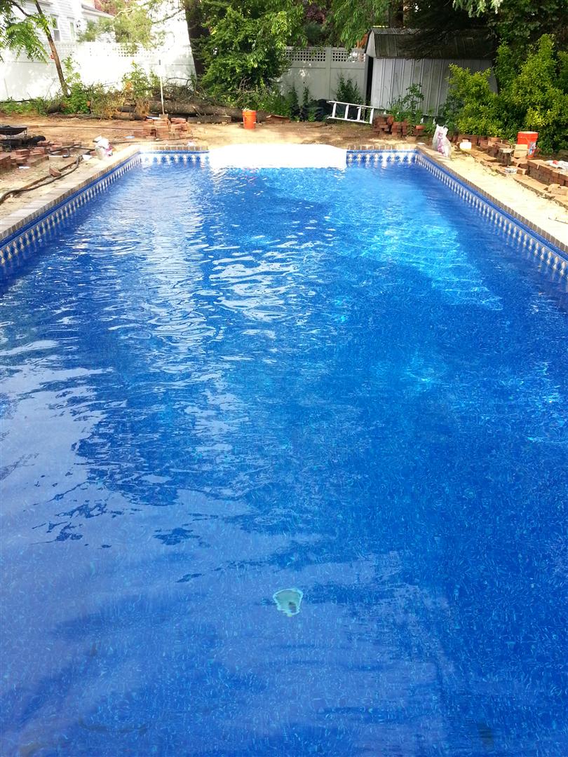

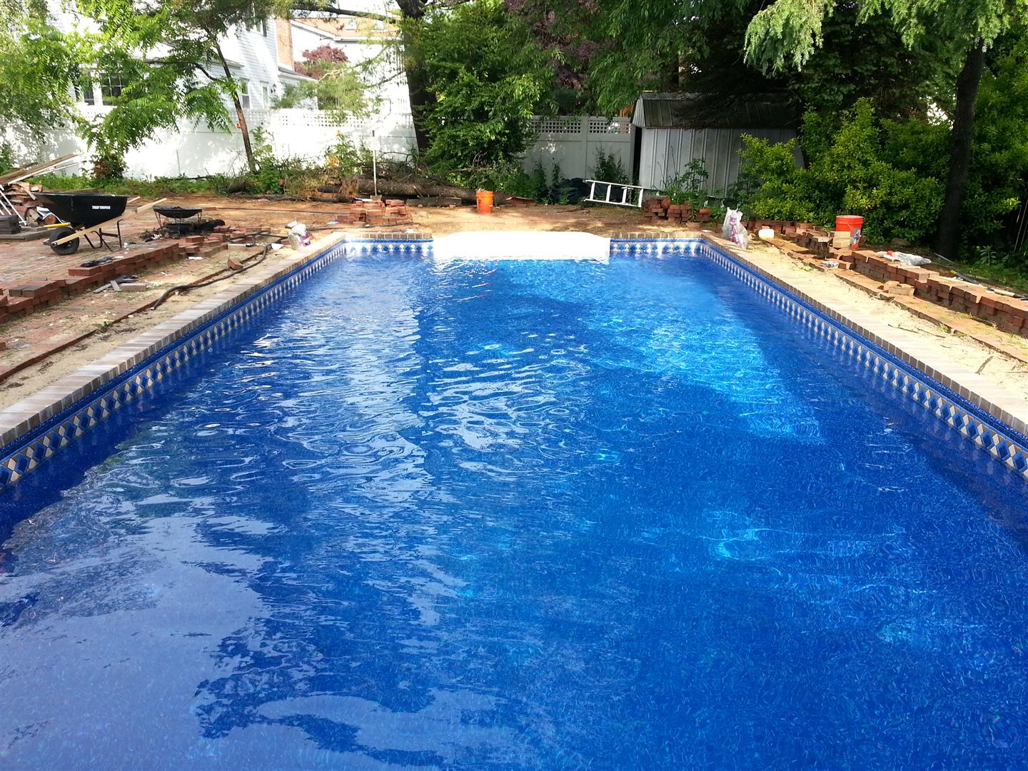

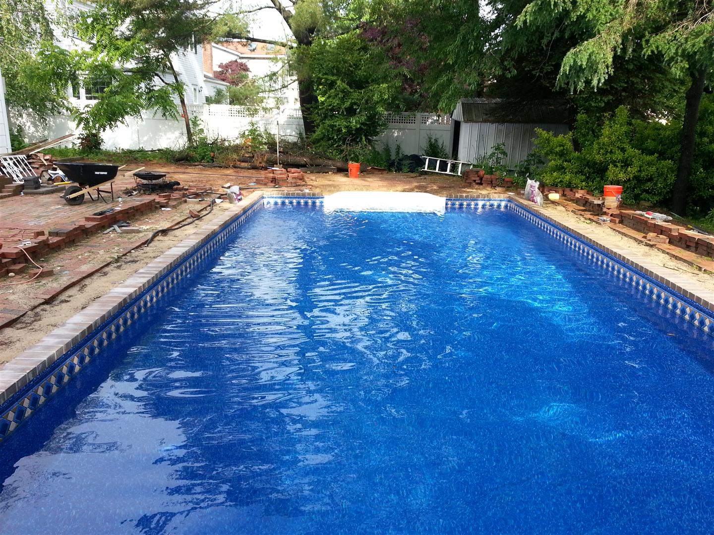

And the filter is running! Not too bad, had to blow out the lines with the garden hose and a rubber stopper, but the pump is running well and has plenty of pressure.
The filter element is in great condition. No DE coming out through the jets.
The pool is just begging for its maiden swim. The liner has tightened up as it filled. There are a couple of wrinkles in the hopper, and in far right corner to the right of the skimmers. All in all, I can certainly live with a few wrinkles considering what we had to do to get here. The corners seem to be about a 4 to 6 inch radius, and the corner below the stairs has reduced to about a 2 to 3 inch radius. Hopefully as we use the pool the liner will work its way into the corner against the stairs and sand.

Dove in for the first time last night in the middle of the pouring rain. The water was frigid, but I've officially been swimming.
Well as usual, there's good news and bad news.
The good news is that the bottom corner below the stairs is fine. Its up against the stairs, and any subtle radius left in the corner has sand behind it, so I feel much better about that.
The bad news is that we lost about 1/4 to 3/8 inch of water in 12 hours overnight, so figure 1/2 to 3/4 inch per day. Now I have to troubleshoot where this leak is. Any suggestions as far as troubleshooting? Ill do a few searches, but my first thought was to hold thin plastic (like a garbage bag) against all the faceplates and see if its gets sucked against the wall. Also, after about 30 seconds of use, my brand new $40 400 watt light bulb seems to have burned out. Hopefully there's some kind of warranty on it. Otherwise the old bulb still worked if I recall, so I will use that for the time being.

I torqued down on all the skimmer and return screws by hand. The skimmers were pretty loose, and I got about a half turn on all the screws before I didn't want to chance pulling out the threads. I didnt torque the stairs or niche or main drain since I didnt want to jump in, but the food coloring didnt show any leaks in the spots I could check from up above.
Anyway, judging by water level against a skimmer screw, we didn't lose any water in the 12 hours overnight - or or if we did, it was less than 1/16. I'm going to consider this success. Now back to addressing these pavers.
