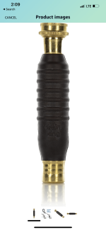

you mean cloth on the outside? I only found rubber bladders so far. Like this one.561EE7F6-8909-40B7-A156-EAF0D3F7CF60.png Can you link me a better one if you dont think this one is good?
Edit: I just goy this one. Just finished school. About to go home ans have a crack at it again
The rubber ones are pretty useless. They break easily.
Hahahaha mine JUST broke
