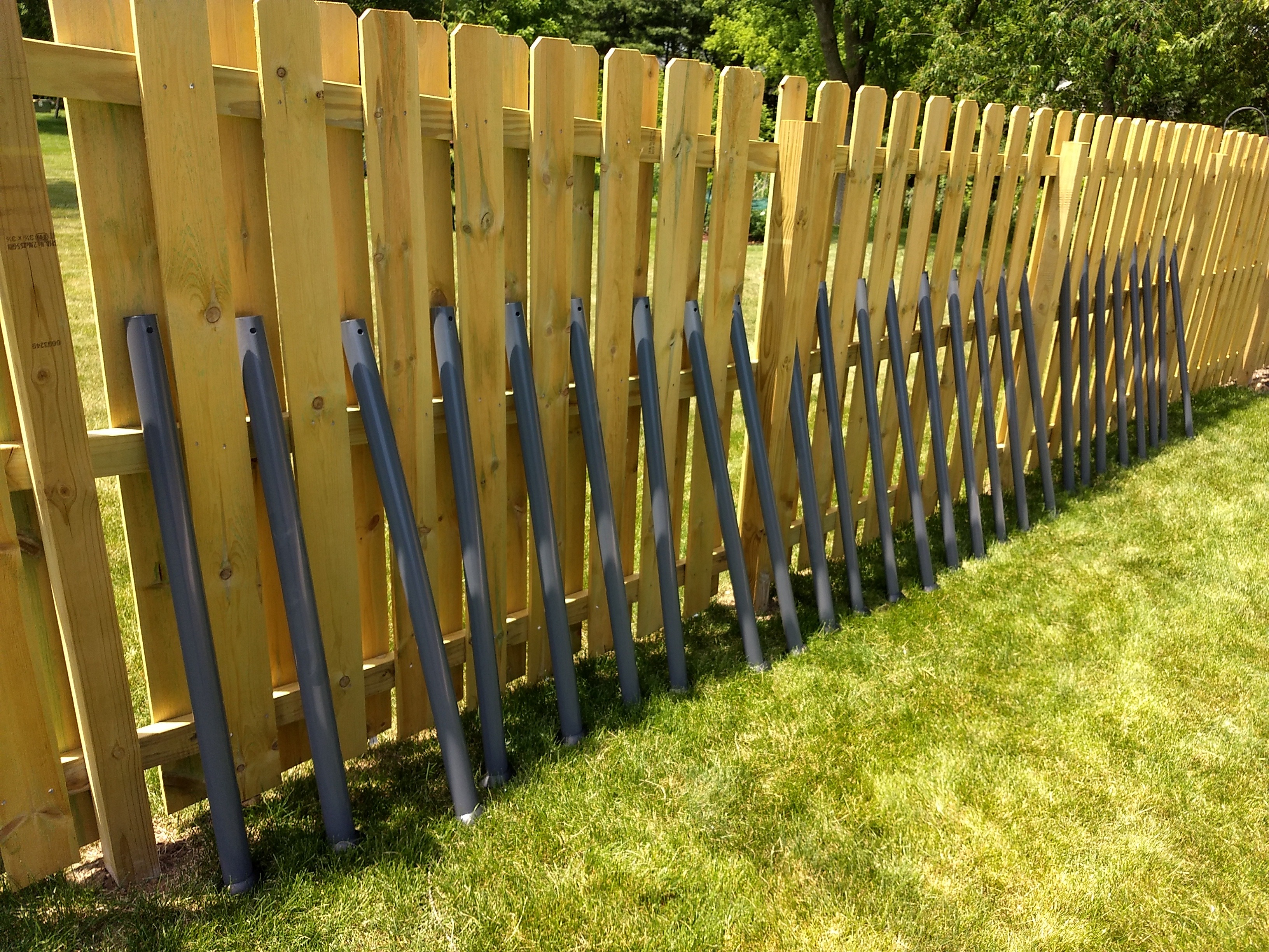

Turns out the only thing I can assemble without the liner is the feet on the vertical posts. I put them off to the side to keep them out of the way till they are needed.
Horizontal supports, also propped up out of the way, ready to go.
