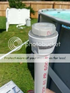

    My fingers would cover (just barely) the end of the pipe in order to get the sample but, by the time I got the pipe up and over the side of the pool, my finger would slip or the pipe would tilt and there'd go my sample. Right back into the pool. Maybe not an issue for a taller person or someone with a pool that they are standing level with the top of the pool. But for me, standing outside the above ground pool and reaching over the side. I needed help. So I made this little jewel.
    I used 3/4" pvc pipe about 18" long (so I can get my sample from down below) and a pressure connecting cap.
    I heated an ice pick with a kitchen blow torch, and it just glided thru the cap. A nice smooth hole.
    Pressed the cap onto the piece of pvc (no glue needed).
    I place my finger over the tiny hole, dip the pipe into the pool, remove my finger so the pipe fills up and the put my finger back over the hole.
    Realizing that all of y'all before me on this thread have already made your sample taking tools, I just figured I'd throw mine out there too.
    TimS, I never thought of putting the hole on the side of the pipe. Even better!
