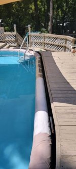

My bonus mom has a 20yr old OG Softpool (out of business now for years) and last summer her daughter let her pitbull in the pool and he put 2 small tears and 2 small holes in the exposed ring (canvas split a few years ago) and we hare having no luck patching using a latex patch kit (for Intex type pools). Someone patched it last year and it didn't even last a year, we tried yesterday and the patch didn't hold when we put air in it today. Pretty sure the ring is rubber, not vinyl. I saw someone suggest "Slime glue" and radial tire patches from Autozone, no idea what slime glue is... I've included a pic of the pool (I'm the one in the background looking like the Mexican pool boy 🤣) for reference.

20 years is a long time for vinyl. Is it even still pliable? I wonder if the vinyl itself is going to accept an adhesive at this point. I personally have no experience with the Slime Glue product, but maybe some others will have more ideas.

We picked up a patch kit at O'Reilly and are currently in the process of refilling... Then, it it holds air, we will patch up that canvas and top off the ring and pool... Wish us luck

Right!? I think 10yrs was the average lifespan, they've taken such great care of it. Unfortunately the deck placement was a tad too close and that ripped the canvas cover over the bladder, then a rambunctious water loving Pitty named Thor punctured the exposed bladder. 🙄 I'm hoping our patch job holds, so far so good! But we're only about halfway and stopping for the night, gonna pick it back up in the morning.
She lives!!! We removed more of the glue from the previously applied marine tape and the tire patches held! So we topped her off, the pump is running, she's been shocked, and are just waiting on more marine tape to finish up the canvas cover!
