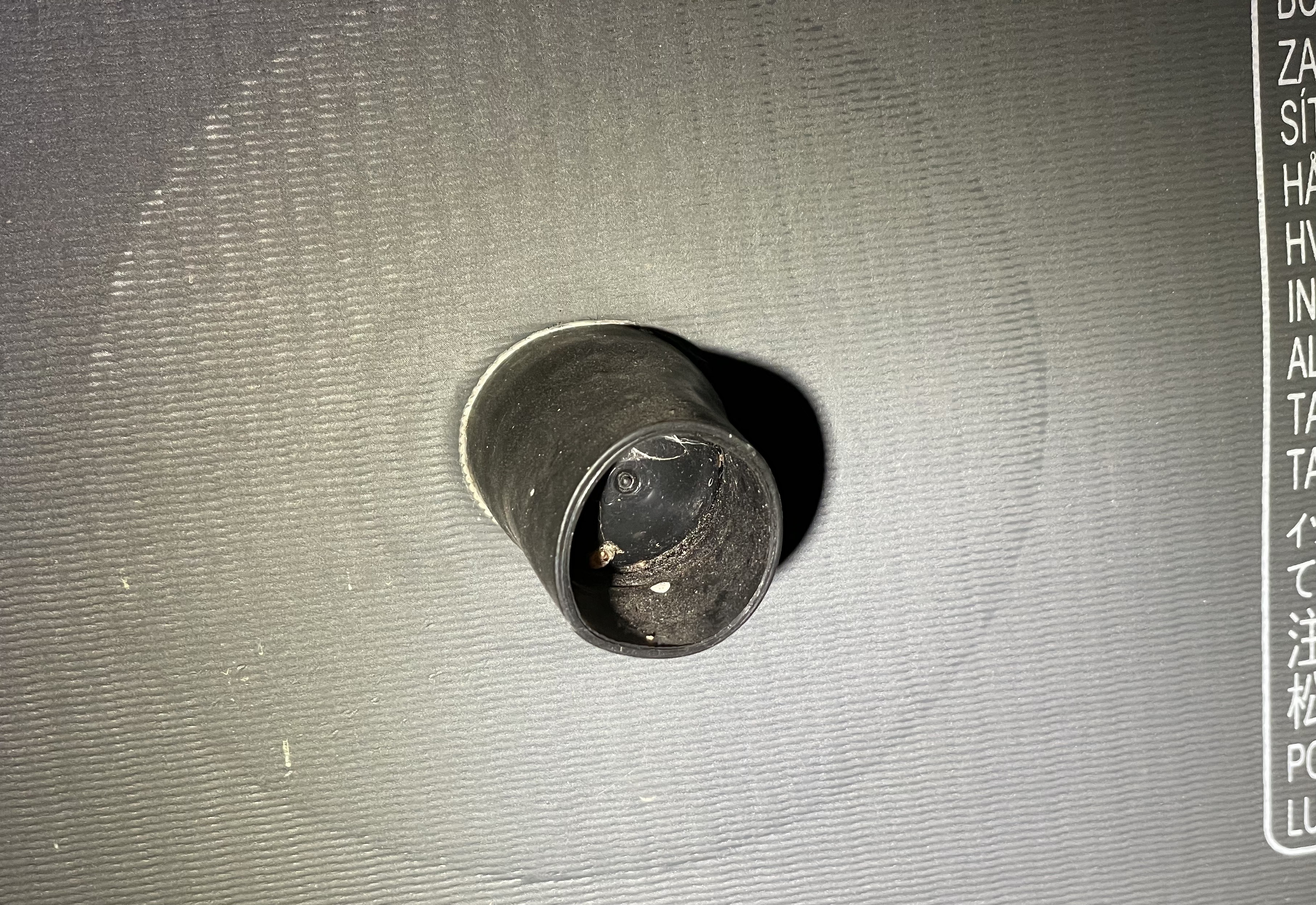

It sounds like others were taking off the threaded strainer cap and also the "plate" labeled "poolside" and reversing the "top hats" to go inside the hole with the top hat end going in through the pool wall inside first and out through the non pool water side leaving the flat part of the top hat flush against the liner, when that isn't the way I saw pictured in the diagram (I'll try and post a picture of that tomorrow)
Yes, that’s what we were doing. Pictures I just grabbed this morning while letting the dog out:
My pool has been like this since spring, as I haven’t used the inlets at all this year (using a Hayward through wall skimmer). Haven’t leaked a drop of water that I’ve noticed. Though I haven’t done it before I will not be draining the water below the inlets this year. I’m draining below the return, removing that, letting the inlets stay underwater and freezing. I can’t really see how they’d be damaged from that, but I could always be wrong. I’ll know more next spring, but I doubt I’m the first person to do this.

@chi-chi I originally wanted to do what Charliej did, but the tophat plug didn’t stay on as securely as I had wanted it to. Not only that, but keeping the strainer screwed on was the reason my pool liner tore up. The ice grabbed on to the strainer cap, and pulled it down when There was water displacement (my fault).
I ended up doing exactly what @jseyfert3 showed in his most recent photos. All outlet fittings removed, Tophat plugs pushed into the 2 holes from inside the pool, with the wide base flush against the liner/wall. Just to be more secure, I fastened the plugs on the outside with clamps.
Idk if that’ll work, but it seems to be the only reasonable solution offered on the forum without having to drain out half the pool.
