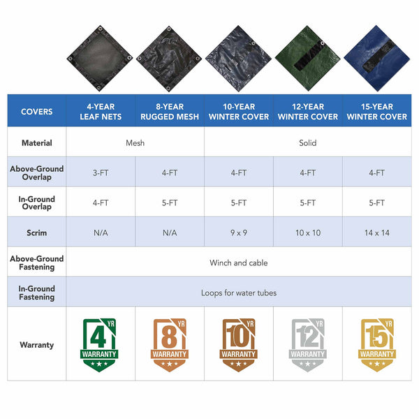

With how hard it is to find stuff for my pool this summer I want to get a jump on purchasing the winter cover. My husband is insisting we do not take it down. What is better? Mesh or
I am considering a Robelle 5718-4-ROB Defender Winter Cover for Round Above-Ground Swimming Pools, 18' Round Pool
Blue Wave BWC704 Bronze 8-Year 18-ft Round Above Ground Pool Winter Cover
now the robelle product had a video describing the difference. However, these seem like just tarps to me? Can I just buy a tarp??
Do you recommend these over the mesh The Robell Mesh are already out of stock on amazon. :( We don't have "leafs" we have pine trees with pinecones etc. But it RAINS a ton... which direction should we go?

Mesh covers can work for ABG but before you go that route you need to have a clear way to anchor it down. Either into a deck, hanging many sand filled bleach bottles around the edge (seriously like 30), or creating a tent like tie down setup with stakes. The mesh cover needs to be suspended above the water and that can make it trickier.
the solid cover basically amount to being more expensive tarps. You can easily buy a thicker tarp but you can’t always find a round/oval one. But a thick tarp would work. These can be simply tied around the pool like a belt with the tarp floating on the water. Some use the metal rope and winch thing that comes in winterizing kits and others just use rope. The two choices for this method are to let it float on the water and pump off any rain water that collects, or to use floats/pillows to create a tent so the water just drains off itself.
there are 100 more details for each way that we can get into once you decide, but the above is the basics of the 2.
