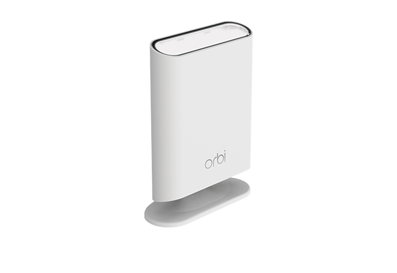

I'll concur with Geebot on the ORBI products. I have a 3-unit ORBI network in the house and have no problem with wifi throughout the yard and pool area.

I replaced my Netgear nighthawk router and and range extender in place for a Netgear Orbi router and 3 satellites, I now have strong WIFI to front curb and back lot line.
225 linear feat- 22,000 Sq Ft.
Check Amazon for factory Auth. Refurb, almost half the cost of new and every bit as clean and complete.
