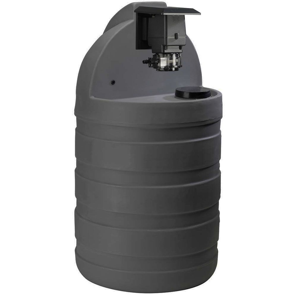

Biting the bullet and purchasing a 15 gallon stenner pump/tank. Last decision to make is GPD sizing which will be either 10 or 22.
My pool is 22000 gallons with a CYA of 40 and I always try to keep my FC on the higher side near 7. I always use 10% bleach with almost a daily ritual of dumping between 80-110 ounces per day. Adding the bleach typically occurs late at night with the pump running and pouring half of the 80-110 oz’s in front of each of the two returns. I certainly don’t do a slow pour but somewhat quickly. I rarely have issues with my water and the chemistry is always correct.
With that said, I figure the larger 22 gpd pump would more closely simulate the way I add bleach and run for a shorter amount of time vs the 10 gpd pump. I’m having a hard time figuring out the math on how long to run the timer so any help is appreciated. Is there any benefit to getting the smaller pump and having it run for longer period of time?

Wow that excel sheet was perfect. Now I'm looking at either a 22 or 50 gpd pump with a 30 gallon tank. Either way, its difficult to find one that is actually in stock on some of these websites.
The 45MFL5 needs 35 to 50 minutes to meet my FC demand.
I found this one with the 45MFL5 but its 3/8" tubing instead of 1/4".......The site says 10gpd but it has to be typo. The part # reflects the 50gpd pump
Rookie question here, is buying the tank and pump separately exactly the same as buying the combo per-assembled system? I'm assuming the pump comes with all the parts I need to attach to the tank right?

I understand that pump output is dictated by tube sizing and I found a good price for 50gpd pump for around 160$ new. All other sizes are well over 200$.
This is what I have. If you have a Coke or Pepsi bottling plant near you they throw these out all the time.
30$ + 50$ for shipping is not bad at all. Best price on a stenner 30 gallon tank with shipping I could find is 240$
