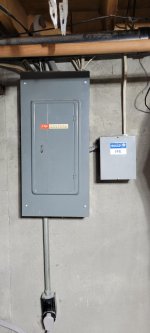

One thing that has/had vexed me is this electrical box. Is fed by the circuit panel. I even had a guy out and he couldn't tell me for sure what it was doing. (He was doing a quote for replacing my old stab-lok style panel. As I have been thinking about it this morning, it is entirely possible that the quote guy they sent may or may not be an electrician...)
Anyway, power goes from the circuit panel (one 15 amp breaker and one 20 amp breaker) into this box. There is a momentary switch on the side of the box. When you push the momentary switch, the magnetic coil is energized to close the connection. And it is kept closed by the power/connection itself being made. Stays connected until, for whatever reason, power is cut to the box. From the box, a single cable goes to the exterior of the house, into a not-great junction box outside, then into the timer, and from there the pump and SWG.
I took another, closer look at the insides of the box this morning. I think what it is doing is combining the two 110v breakers to make a 220v circuit to feed the timer and pump. Looking closely at the Romex cable, I am certain it is 12g wires. It is stamped, not printed but it looks like larger than 14g and I am certain I saw 12 on the jacket. I think the pool setup is old enough that the wiring was done before the jackets were color coded to yellow for 12g.

Yeah... Both of my houses have the Stab Lok panels. (When we bought this house, we kept the first and have rented it.) I'm aware of the potential issues, though some electricians I've talked to over the years (e.g. when I bought the first house) have said they feel is is somewhat overblown while when I had the guy out to just see about running a circuit to the garage (because I was thinking I was willing to pay someone for their time vs. spend my own time on that project) he said they wouldn't touch it with that panel in there. So of course I'm thinking about it.
I asked about upgrading to 200 amp panel-he said that because my electric comes from underground and something about how the service enters the house, that doing so would be a big hassle/open more cans of worms and I wouldn't really see any major benefit based on the consumers in the house, especially since both the water heater and furnace are gas not electric.
I hadn't actually thought of replacing that box with a sub panel, but it does seem like a good idea now that you mention it! No reason it couldn't continue to be used if/when we have the main panel upgraded, so then the only waste would be buying a proper double-pole breaker to power the sub panel.
I could run the pool stuff as well as 220 for my welder and a 20 amp circuit to the garage if I did that! (Currently, the garage has one outlet, and it is the last outlet in the circuit that runs the kitchen lights! Major pain and no good. Stupid late 70's home builder.)
I'll take more pics tonight of what I have going on. But the romex exits the house into the back of a box outside, but as I'm thinking about it now, I think it is just romex from that box over to the timer! And that box is definitely not properly secured anyway.

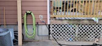

At the box where the wires exit the house and go into the back of a switch box, you can see that they cut the tab off a light switch to be able to use it to screw the switch cover back on to "close" the box! Also, the 18ish inches of romex from there to the timer is only 14g. And none of the wires going to the timer seem to be actually clamped to it. Black cable coming out of the timer goes to the SWG controller.
The wide pic shows how all this is under my deck. None of it is very far from the house service, so no wire runs are longer than a few feet.

Here is the area I would like to move the pump controller and SWG controller to.
The pump and filter are located under the deck, just behind the lattice.
Any reason the electrical stuff cannot be located on that wall of the house? Mounting above the hydrant would be simplest overall. Would it be against any codes to have that electrical stuff right above a hydrant? Or how about on the side of the deck?
If neither of those are acceptable options, I could mount the timer/SWG controller to the left; there is enough space between the AC unit and house to access them easily enough. (The AC unit being in the pool area is a whole other ball of wax that I'll need to deal with at some point, probably when the ancient furnace finally gets replaced.)
I'd like to have the controllers in the pool area, because to get to them currently, I have to exit the gate and crawl under the deck to get to the pump timer/switch. And the SWG controller is above the deck, though that is less inconvenient as I don't have to mess with it much and it is next to the back door of the house.

Dave,
I like the idea of going with 120 volts from your existing breaker panel into a small subpanel mounted above your faucet. The subpanel would have a 120 Volt GFCI that feeds your timer also relocate next to the new subpanel.
This gives you the GFCI you wanted and moves things where you can get at them.
I would mount things about eye height above your faucet, so it is easy to see, and operate.
Jim R.
