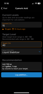

As far as the CYA, I must be missing something, the original 15 CYA was an estimate because I had 0, added 1 gallon liquid and it still couldn’t read on the TF Pro kit. So this morning I added another gallon, my pool math app is suggesting that should bring it to 40 or so? I haven’t been able to test yet, unfortunately won’t be able to until later this evening.
Here’s a picture from my pool math app, maybe I have something wrong put in?

You should be good with CYA 40 and a SLAM FC of 16.

I am confused how many gallons of liquid stabilizer you added.
1 gallon of liquid stabilizer will give you 25 ppm of CYA.
I added one last night, all I had yesterday and stores were closed. I tried to measure but couldn’t detect as the tf pro gage only goes to 30 lowest. The 15 number was just a guess I put in since I couldn’t actually measure it.
I added another gallon this morning and have not yet been able to measure, can’t until later tonight when I am home. But if 1 gallon makes 25ppm I guess I should be around 50ppm.
I would assume a CYA of 60 and a SLAM FC of 24.
