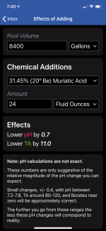

So they gave instructions to add muratic acid (24oz) away from skimmer and returns, run filter 30min then leave off overnight, then run filter in the am at least 4-6 hours (we do 8hours daily) and retest in 2-3 days. When I put that amount of MA 31.45% into the pool calculator it only says it will lower TA by 11 is that the correct amount?

My advice to you would be a little different....
- Stop with iron product for the moment and make a DIY polyfill filter like the ones you see in the clips below. Get rid of the iron, don't just try to keep it in suspension or you'll always be battling it.
- Make sure your CYA is at least 30, perhaps even 40 this time of year if you get a lot of heat/sun.
- Keep the FC balanced to the CYA as noted on the FC/CYA Chart.
- For the TA, let the pH rise to 8.0 then use enough acid to lower the pH to 7.0. Then wait (or aerate) to let the pH naturally rise to 8.0 and repeat. Each time you do that you will knock the TA down a bit.
- Don't waste $$ on algaecides this time of year.
- Trust your K-2006 kit; don't bother with the pool store.

Oh my. What an odd way to add MA??? I wonder what the Pool Store thought that was going to do? As Texas Splash says Polyfil is your new friend!!
Take your test kit and test what ever water you used to fill the pool. Lets see how high that is to begin with?
Stop using the Pool Store for anything at this point. They're mostly worthless for advice and questionable for testing accuracy.
When testing your FC and CC, use 10cc of pool water so that each drop of 0871 reagent equals 0.5. In short...count your drops and divide by 2.
This saves your reagents. :)
Ignore phosphates.
Do not use any product that also adds stabilizer or calcium at this time. Vinyl pools don't need added calcium.
Add 1/2 gallon of plain unscented non-thickened bleach daily and brush. Do NOT use Clorox or any bleach that advertises that it has new technology or some other adspeak. Plain, usually on the bottom shelf. Or Liquid Chlorine found at Walmart in pool section or Lowes/HD.
Lets see how your new resuts stand.....
It's called an Acid Slug. It's an old technique that's supposed to make the acid lower TA without lowering the pH based on [realistic explanation missing]. It's a wonderful example of something "industry experts" recommend because they were taught it and have never bothered to question the validity of the practice. A reminder that "some pool guy told me this 40 years ago and since then I've repeat it as fact" is how the industry operates.
