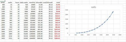

I have an IntelliFlo VS pump that trips my heater around 1,400 rpm. At 1,500 rpm, my pumps pulls just over 200 watts. By comparison, a 1 hp pump probably draws close to 1,000 watts. I run my pump mostly at 1,800 rpms (about 360 watts) and a couple hours at 2,400 rpm (about 850 watts). Here are a couple pics of my pump display to give you an idea of how rpm's effect energy consumption. Pump Speed.jpg
Here is a chart that demonstrates the correlation between pump speeds and energy consumption (3 hp pump).
