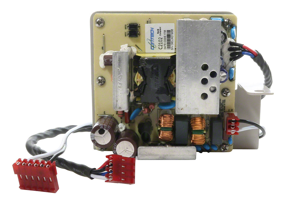

Here is what the back of the display looks like.
Ok thanks. We just followed that and according to the trouble shooting testing, it is the 12/24 power supply assembly.

Certainly looks like you could replace it yourselves. It might be worth double-checking fuses on the board. I doubt your recent solar work caused this, PSU's fail from a variety of reasons including voltage surges.
